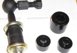

I'm getting ready to put my anti roll bar back on the car. I have new bushings (poly) and links, etc. My first question is how in the Sam Hill do I get the bushings on the sway bar? Do they remain intact, or do I cut them lengthwise and wrap them around the bar? Secondly, the poly bushes for the link have a little raised inner cylinder that sticks up about 2mm from the rest of the bushing (rubber bush on link lacks this). I'm assuming this is supposed to fit in the hole in the sway bar, but that would mean NOT using the inner "cymbal" (black metal ring on link in photo). I can use the cymbal with the poly, but that raised area would serve no purpose if I did. What would be best to do? Third question: Though not visible in the picture, the two rubber bushes on the link are riding on a single metal sleeve. If I were to use the rubber, am I supposed to cut that in two? If I use the poly, am I supposed to cut it in two and transfer it to the poly?

The large bushings for the sway bar (they should have a slit on one end) need to be pried open. I used a large flat screwdriver and lubricant--its a little tough but they will go on, Im not sure what you are asking about the links, but you do not have to cut anything, I would use only the larger shiny plates behind each bushing, the smaller plates are not needed,the inside of each bushing fits up directley to each side of the hole.after the bushings are compressed they should seat on the plates and bar just fine, but dont over compress--there should be just a little bulge on the side of the bushing.
I found that the only way I could get the larger bushings onto the sway bar was to put them in boiling water for a few minutes. They were then soft enough to push over the end of the bar.
I used all four washer/cymbals on each link, but only because the man at Moss told me to! I think that the shape of the cymbal washers helps to stop the bush spreading and splitting, but that's just my guess. The metal sleeve was stuck on the link when I removed the old rubber bushes, so I didn't move it and the bushes went on fine. The problem came when I tried to attach the links to the bar on the car - I just couldn't compress the bushes enough to thread the lower nut. In the end I removed the centre mountings (large bushes) and then the links fastened up reasonably easily. Then I had to re-do the centre links under the radiator. What a pain that is...
