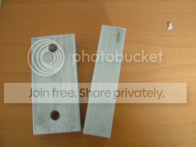

Anti Dive...
DNK
$9.00 for the aluminum
$3.00 for the hardware.
Results
Priceless
I was going to order a set for mine, but after installing the firmer springs, poly bushings and new shocks and uprated brakes, it was cured. A lot more expensive, but it needed all of it. (Well, it didn't NEED the uprated brakes, but I decided to treat myself. :smirk: )
Woody says they're probably not needed after all those changes but for $12.00 and my time. Why the heck not!
enlighten me. how do these work and where do they go? I fear this is one of thos obvious things that I will hit myself on the forehead when I read the answer.
Sorry - it's a Wedge thing!
They're prone to diving with anything more than very slight braking. The blocks fit at the sway bar mounting points, changing the geometry of the front end.
