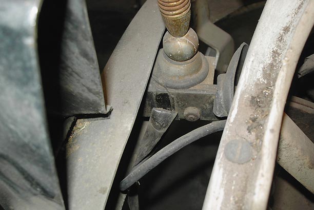

The dealer installed antenna for my car was on the rear bumper. Never seen it like that on another car. No drilling required in the body at all, wire came into the car through the bumper bracket opening. The downside, it was pretty ugly.

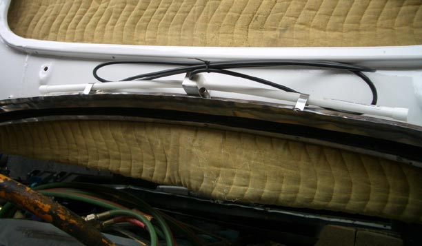

That antenna will not be going back on my car. Even if it wasn't trashed (broken and rusty). I will be trying one of those hidden ones that the hot rodders use. I'm going to try it under the lip of the rear shroud. Honestly, the choice of radio stations here in the Los Angeles area is lame, I usually listen to CDs or my MP3 player. Yes, it will be loud enough to hear over the engine, and wind. :devilgrin:
