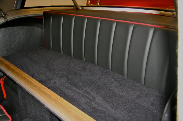

I will be making a coast-to-coast trip in “The Bloody Beast” in the summer of 2009. It will require that I carry along with me everything I will need for a month. Of course, space is at a premium in a Healey so I have looked for every opportunity to expand storage space. I recently thought about how I might obtain more usable space in the interior of the car.
The occasional rear seats in the BT7 may make for lovely seating for small children, but they do not provide a level platform to store items you might wish to transport with you on longer trips. Later models of the Big Healey have a fold down parcel shelf behind the front seats, so I thought why not in a BT7?

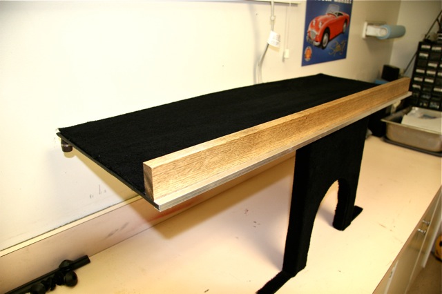

What I came up with does not fold and frankly you must commit to having it in place, or not, when you start a journey. However, it is easy to add or remove from the vehicle. You will note it has some small rear "legs" and there is also a support in the back of the shelf at the midpoint. These supports keep the shelf from actually contacting the leather seats.
A pdf file of the project (measurements and materials) as well as high resolution images may be seen at:
https://web.me.com/linwoodrose/My_AH_3000...aintenance.html
As always, Cheers!
Lin

Good Job, Lin.

As for the shelf you constructed, I think it looks a lot better than the phony seats, and I'd be inclined to leave it in permanately. Good job!

Looks like I'm third in line here to say, great job! I'm impressed with your design and how you share in detail, how to make it.

Lin, very nice it deed!!! It looks integral to the original design.
