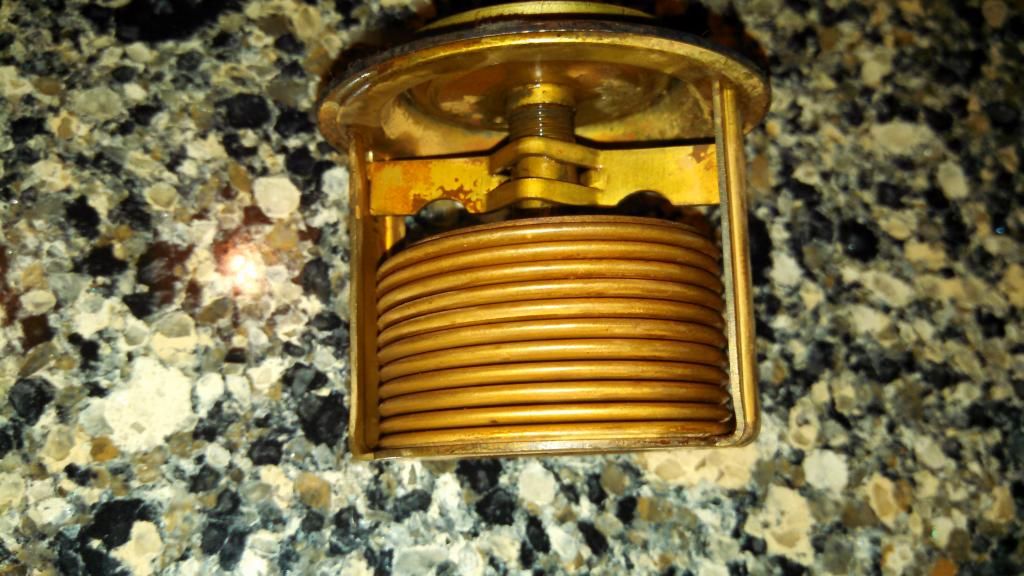

My thermostat quit today, was driving around and it started to overheat, usually runs pretty cool, had noticed it wavering around a bit the last time I drove too
Imagine, breaking down after only 46 years, it looks like the little tab that is supposed to hold the crosspiece in place wore or corroded off, causing the crosspiece to sit sideways on the shaft and bind, kind of hard to see in the pic, but the right side is lower.
Actually thought the originals was kind of cool and left it in after my rebuild five years ago, assume it is original as people seldom replaced them with the more expensive bellows type back in the old days.
I only had a spare 160 F lying around and it runs really cool now, only going about a quarter up the scale, will probably go get a 180 F one tomorrow, was that the standard temp as original? looks like I could get a 195 too.
Kind of hard to say. According to the workshop manual, the original Tstat started to open at 160F (70C) and didn't get fully open until 197F (92C). Since normally they are rated by the opening temperature, that would make it a 160F thermostat. But, it opens so slowly that normal operating temperature will be well above that. So I think a modern 180F is a better approximation.

Thanks for the info, I think the internet makes me lazy (always blame an outside factor, never take responsibility) as after I posted my question about the stock thermostat I found the answer in my trusty Haynes manual, which was all of 5 feet away from me at the time. Got a 180 F thermostat and a gasket at the FLAPS, always a bonus when you can actually go down the street and pick up a part locally, even listed in their database as correct part for a TR250, so avoided the usual confounding of the parts counter guy by telling him year make and model wont help in his search.
Thanks Randall, I like technology, but I still feel I can flip through a book faster than a scanned or otherwise stored book onscreen, but it would be handy to have all the guides stored or available on a cheap tablet out in the garage. As an aside, I drove around with the 180 thermostat today, and the gauge, once the car was warm, stayed in right in the middle between the two small dots that I think are there to show where it is supposed to be. Never have had an old british car that runs so cool the thermostat actually determines operating temp til the TR250, I had the later big red fan on the car, but took it off when I realized I didn't need it and it was probably robbing a couple HP.
