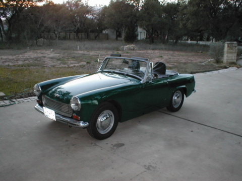

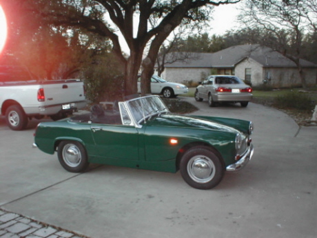

Second, I have a announcement... About two weeks ago, a miracle happened and I actually got my looooong overdue '69 MKIV project back on the road again!
This would not have happened without the help of a good British car specialized shop in Austin! I took the car off the road over 3+years ago. Initially, it was to do a Rivergate 5-speed conversion...which morphed into an engine rebuild...a this...a that...etc...etc...
For the last year or so, the car was at a state to where it really should have required another day or two worth of work. Personal issues got in the way and that work never got done. When we sold our home, I knew that I was at the point to where it had to be done, so I contacted Ron Shimek (Austin). He and his team took on the task of finishing a car that they didn't have a clue as to what I had done. Even though I believed I was meticulous about all the work I did, things happen. The engine was strong, but I apparently hadn't gotten the rear engine plate sealed good enough, so that was leak 1. Additionally, Ron realized that I had the clutch fork set within the Rivergate specs, but the fork wasn't moving far enough to have the throwout bearing fully engage the clutch. Ron talked to Rivergate and found out that this happens on a few cars (mine being one) and the fork needs shimming. Once done, leak 2 showed up as an oil gallery plug needing a bit of teflon tape. Ron also helped reconfigure a concern I had of the location of the positive battery cable connection on the new starter I had installed. It would only clock one way and that left the post too close to the oil pan.
Two weeks ago, I got the car back from Ron and am now a happy camper/driver. Engine is strong, 5th gear is nice, car sounds great... and all the squeaks and rattles are still there for me to start tracking down!

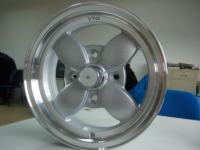

If anyone knows of a really good deal for an interior panel set or set of minilite style wheels, tell me. My attempt at panel making ended up with the panels being too thick... and all the wheels on my car look great after I powder coated them, but the PO(s) must have like driving through every pot hole on the planet, so they can't be completely balanced.
