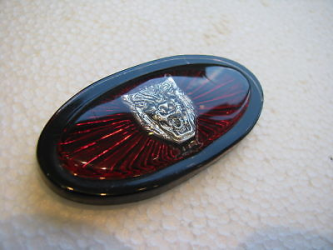

In the process of learning about my newly acquired 1969 Series 2 XKE Roadster I've discovered something rather "unusual" about the motif bar that is mounted in the front of my car. Since my car came to me without the motif mounted inside this bar I figured I would make an easy installation of one that I purchased from Terry's Jaguar. However when I tried I discovered that it simply would not fit. Specifically it was a little too wide and way too short. (?)
I've verified that this is the correct oval shape and size for my car and that it fits correctly in the aftermarket motif bars sold by both Terry's Jaguar and XKs Unlimited.
So....what the heck kind of motif bar do I have mounted on my car?????? It sure looks exactly like all the others but that opening is clearly the wrong size.
I'm attaching a picture that illustrates the mismatch..
If there is anyone on this forum that might have a clue to help me (a) solve this mystery and/or (b) know where to get a motif that fits it would be greatly appreciated!

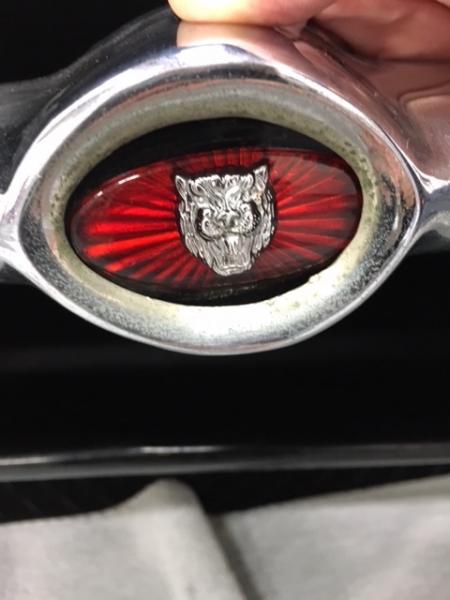

I also have a S2 OTS and here are a few pics of mine. The emblem does not really match the opening... IOW, yours may possibly be fine if mounted correctly:
Thanks Geo - your motif bar exactly matches mine. I think there was an undocumented variation in that part during production as I've looked at other 1969 Series 2s and their motif bar openings are a perfect match for the (current) aftermarket motif that is being sold - no space around the top and bottom.

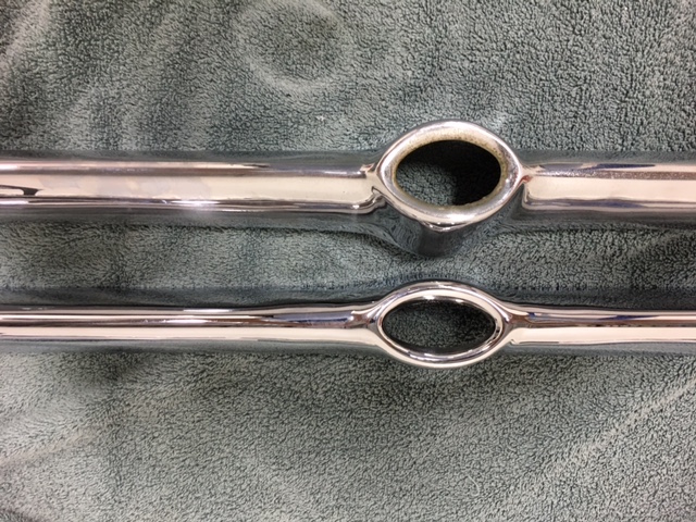

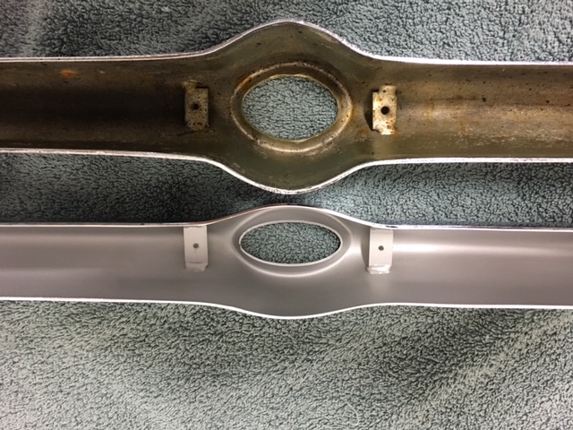

As promised here is my update now that I've received and installed the motif bar from Terry's Jaguar Parts.
First, there is clearly a big difference between these two bars (old bar is on the top):

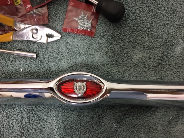

The motif fits perfectly in the new motif bar:

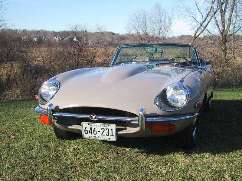

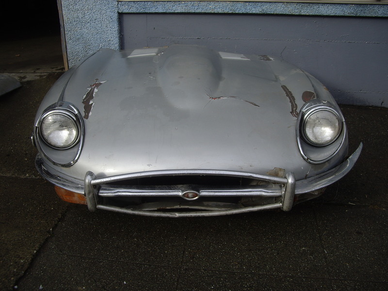

While I was waiting for the new motif bar to arrive I did a quick search on xkedata.com and looked at photos of cars with VIN numbers a little higher and a little lower than mine. What I found verified that my original motif bar is shared with other cars and did in fact accept a different (and larger) motif than the vast majority of other Series 2 cars:
For example, compare the size of the motif in the above picture of 1R9711 with the motif in the picture below of 1R9701:
I found a number of other examples of the larger motif so at least I can now answer my own question of "what the heck size motif bar do I have mounted in my car?" :smile:

...Unfortunately I've not found anyone that manufactures a motif that fits the larger opening...
And possibly jaguar didn't either. IOW, it seems to me they used the same emblem in both the big roundish and small ovalish openings. Hard to tell in that 4th photo - clearly the rounder opening but possibly the same emblem.
The repro does look better.
