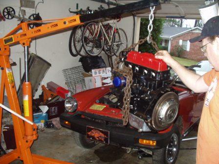

Just got back from dropping the motor off at a local shop,to have the lower end rebuilt. Turn the crank etc. Included some pics from our rainy day in the garage.

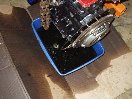

We drained the fluids and ran a magnet through looking for signs of metal shavings. None, found. We did find, however, clods of dirt. Like a dirt dobber's nest. Hmm...maybe we should have flushed and cleaned before we installed and ran /bcforum/images/%%GRAEMLIN_URL%%/confused.gif

Did it spin a big-end bearing after all?
And here she goes.....
The #2 is loose. (It had a little play in it) We didn't tear it apart completely because I wanted it together when The Local British Car God looks at it. He said he should be able to get to it on Monday. We are hoping for a clogged oil duct and the dirt in the oil pan is a good indicator that there was something going on in there. We bought the motor from a guy in Lousiana and we took off the head, removed the oil pan etc. It looked like a nice rebuild. But, knowing the south and how insects get into everything if you are not looking, and knowing that it had sat outside for some time, we should have hooked it up to a high pressure hose and blown it out completely before installing it. There were no metal shavings in the pan just dirt clods (about the size of sand grains)I know the rule is the most expensive problem is probably the one, but we are hoping for minimal damage to that bearing. (Or even none at all /bcforum/images/%%GRAEMLIN_URL%%/crazy.gif)
Bearings are cheep. Hope it did not scar the crank journals.
However, even that is not bad but a thorough tear down and boil everything etc etc is in order for sure.
