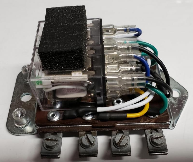

I had this problem on my BN6 and, after replacing a couple of the flasher units, it was evident the problem was in the flasher relay itself. Finally gave out after 60 years.
I rebuilt it using modern relays per Jean Caron's method and as inspired by Ray (Rac68). Foam holds relays tight inside cover.
Also suggest use of rivet nuts for upper two screws for future ease of removal without removing fresh air duct.

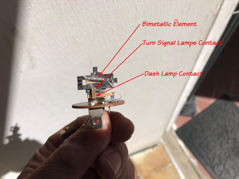

I was having a similar problem last week after I installed LEDs in my brake/turn signal/taillight lamps (Thanks Ray). The fronts are still halogen bulbs. The turn signals would work fine on the outside, but the dash lamp would only flash once or twice at most.
When I changed flashers to one for LEDs, I took the case off the old one. The contact for the dash lamp (warning lamp) is just copper to copper, whereas the main contact is a bit more robust.
As an aside, using the flasher made for LEDs, the dash lamp would continue to flas for a while after the turn signals were cancelled.
