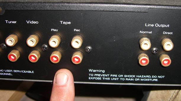

If you have a tape loop on your receiver, that would be a good place to tap into the signal. Use the record outputs (see photo) and use the cord Scott mentioned to go into your computer. If your computer's audio is integrated on the motherboard, do a test recording and listen to it with a good pair of headphones. When the DACs are on the motherboard, you can pick up noise in the recording. An audio card in a PCI slot gets the DACs far enough away so that won't be a problem.
