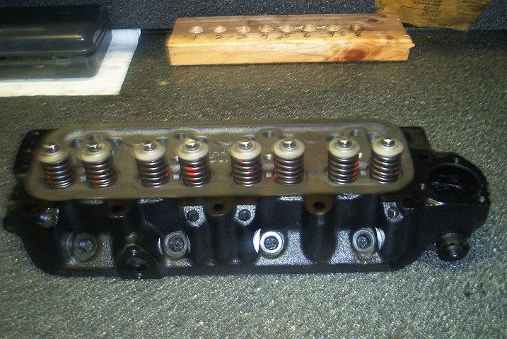

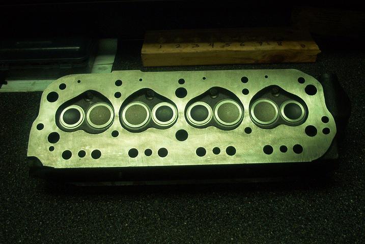

OH, here's a few pics of a new County Cam1106 head, I checked it over good, I had heard all kinds of myths by the experts about these heads, not having the same ccs in the combustion chamber and such, all BS, this in my opion the best choice for a let model MGB when it comes to head replacment. they come complete new valves, new springs, new everyhting, even paint factory black, ready to bolt on.

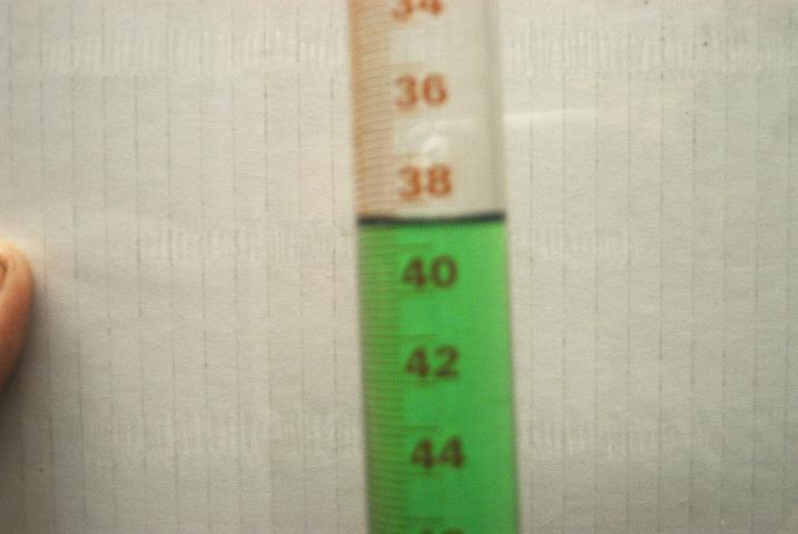

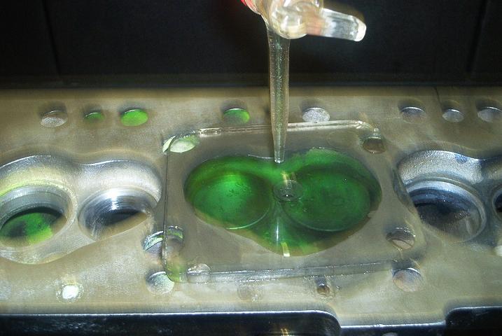

Here's picture of the CC volume on the new County head, and right now with Moss' sale you can another 18% off, so that drop the head down into the lower $800 range, not a bad deal really.
