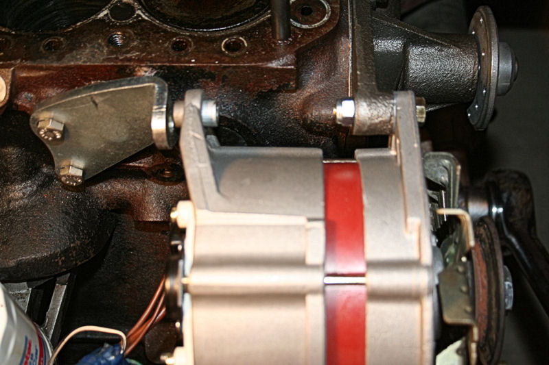

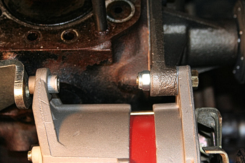

Ok I cant catch a break and the alternator will not line up. Did I buy the wrong bracket? The lineup is close but no matter how much adjust the bracket I can not get it to line up correctly.
If you got the bracket from Moss, SENT IT BACK. The one that I got did not line up and one other person here in Seattle also got one that was out of line. You will have to use the old bracket and a long bolt with a spacer.
ACK. Not what I wanted to hear. Unfortunately I don't have a stock setup as the DPO had a Picasso to redneck engineering and booger welds and somehow mounted a unknown alternator upside down from the stock setup. Guess I have another reason to yell at moss tomarrow.

Stewart - I had the same problem with the bracket from Moss when I put an alternator in our daughter's car. I used a rat tail file to elongate the hole to make everything fit. If I remember correctly, the hole is too small for the bolt anyway. Bottom line - the bracket is junk!
