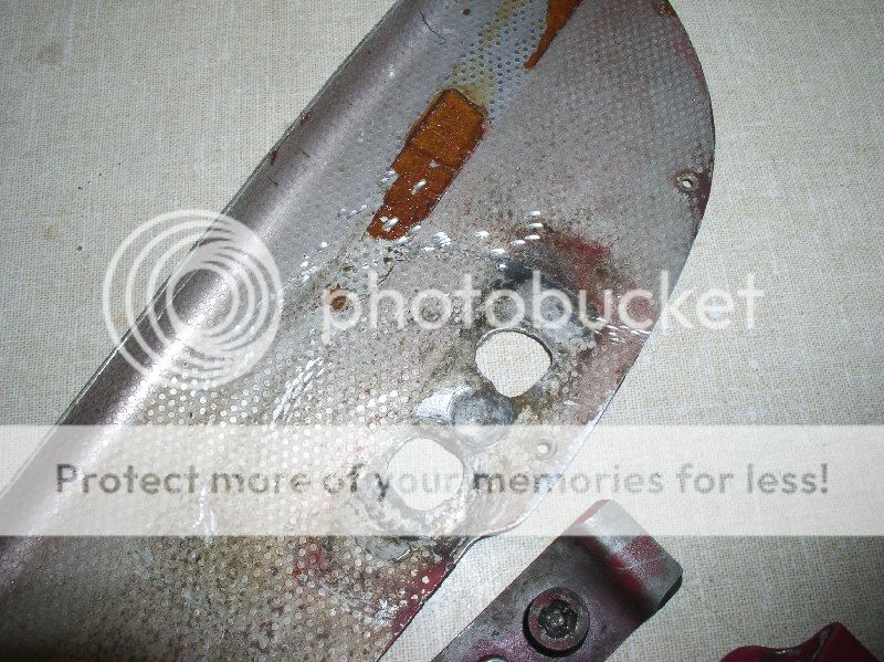

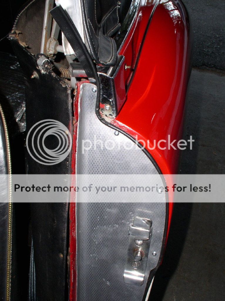

My aluminum sills were pretty bad, but I got away with using a dental tool to pick away the blackened corrosion, then wire brushing, then polishing.
Couple of record shots showing the strike, which wasn't as bad as the sills..
