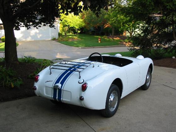

The Bugeye is a real "Spriget" As I told Jack Laird when he was looking for his car a few years ago, buy a complete car not a rolling chassis like I did. My car is a 1960 Bugeye, but since I started with just the tub, rear end, worn out front suspention and a badly rusted-bent bonnet (bought 3) I had to buy EVERYTHING else.The car is far from a restoration, it will be used as a fun driver and along the way I'll still be looking for and replacing non original parts.
The paint is a Artic White Acrylic Enamel that I shot myself ( It's almost idiot proof ).The stripes are vinyl tape. The interior is a dark blue carpeting and black leatherette side pannels. The dash is from a Midget and has the black speedo and tack, along with Auto Zone black oil and temp gauges and a am-fm c/d radio(car is converted to neg. ground).Although not original the dash looks prety good.
The luggage rack was bought off of E Bay and the hardware came with it. The mounting bolts appear to be stainless carriage bolts that have been polished.
