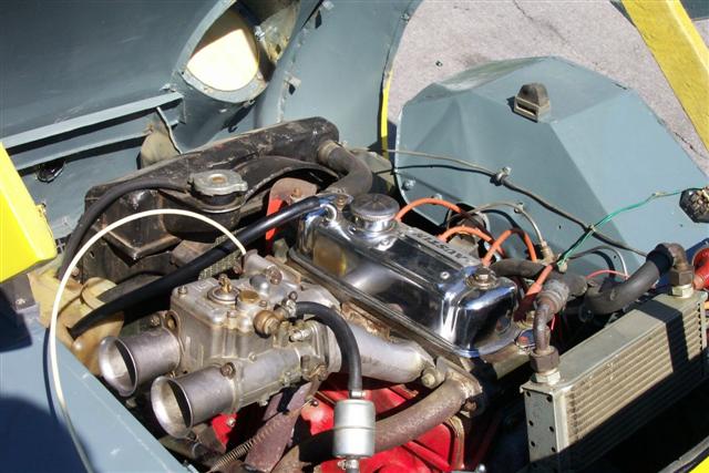

Hits the top of the front carb and therefore he cannot eliminate the incorrect gap between the bonnet and the rocker on the driver's side of the car. He was asking me if the mounts were wrong or something. My reply is that the carbs and mounts are supposed to be that way. Am I correct in thinking that problem has to be in the hood? The cross support in the rear of the bonnet has been removed and re-welded to allow for "adjustments". How in the world are we going to fix this problem? Are there adjustments in the motor mounts? Hard to remember, but I do not believe that there are any adjustments to the mounts.

Have you got a picture of the engine bay?

The hood is hitting the front carburetor and thus not allowing for the hood to "close"the rocker gap.
Ah, I got it. Well those hinges won't cause that unless the rockers have been replaced and are in the wrong location somehow. The engine mounts won't give much adjustment obviously. How tight is the body guy trying to get the rocker gaps?

The reason I asked is that the Mini manifolds have a different angle to them, causing the carbs to be tilted up higher.
Just a guess as to a possible solution.

Looking at the video, I think the manifold is wrong. Are the float tops level?
The carbs are angled slightly. The fueld routing has since been corrected. I wonder if this is in fact a Mini manifold?
