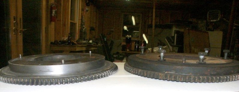

As Jack said earlier, the flywheel does not make power although it does contribute to a tiny amount of parasitic drag, but that is not really what you feel when you swap to a lighter flywheel. BTW the same effect is seen when "wedging" a crank as per Vizards book, just like an alloy flywheel it lightens the mass of the rotating assembly and the engine becomes snappier and you think you have lots more torque and thus hp.
