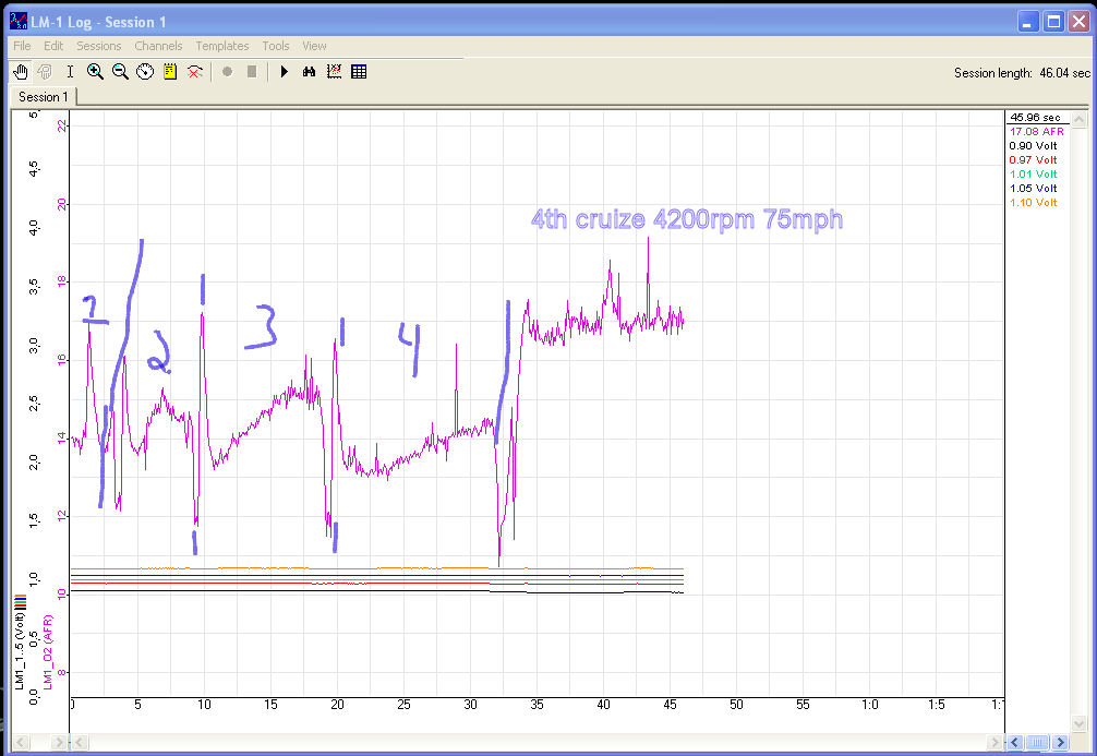

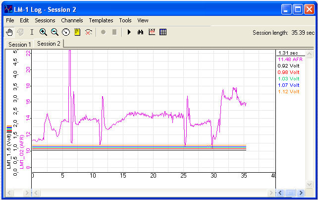

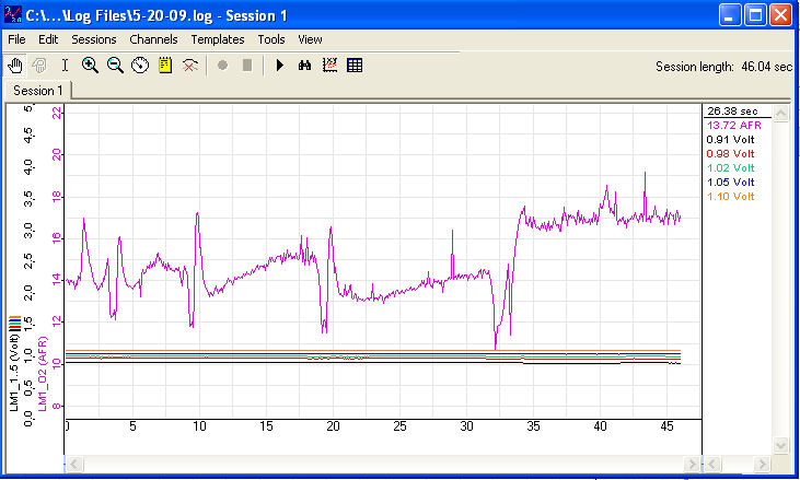

I'm playing with a new toy an innovate LM-1 air fuel meter and hopefully the guru's on the board can help me decypher the results
I'm thinking right now I'm rich at idle with it being at 11afr +-.1 about right in the midrange cruise at 14.1 @3500 rpm 3th but lean at highspeed cruise at 17+-.2 4200 WOT was running in the 14's to 16's
