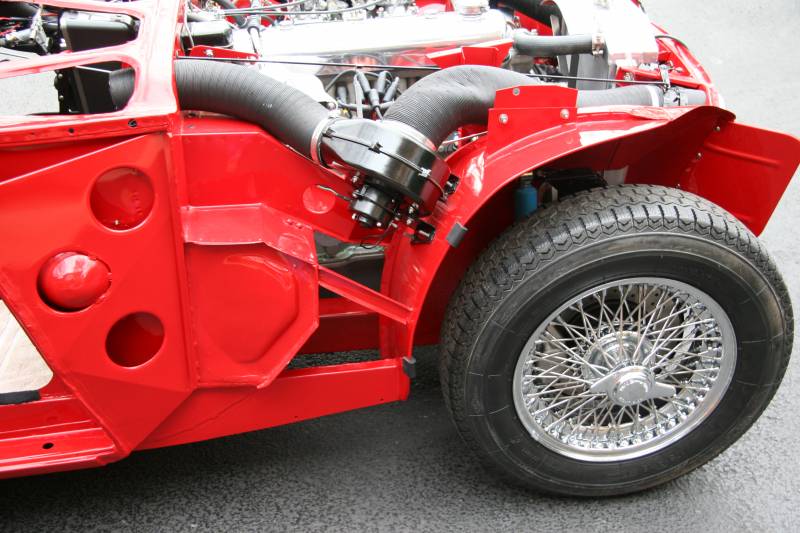

Well, going back to the original question after some cart and salt flats diversions (which I enjoyed by the way!), the answer to your question is that the splash panels are body color as the photo below shows.
Lin
