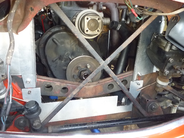

Started with a smaller baffle to attempt to isolate the fresh air intake from recirculated hot air, then morphed into a project to surround the radiator with baffles to prevent forward recirculation of hot air in general.
If anyone's interested, have photos:
https://www.pbase.com/stevegerow/healeyairbaffles

When installing the bilge blower with variable speed control and under-dash baffle to redirect air flow, it was my presumption that the air secured by the powered cold air vent would be pulled through the grill. Although that may be the case when under power, it definitely does not seem to be true when experiencing the warmer air flow when standing for a traffic light. Since Steve also experienced this heated air, it was concluded that the air now PULLED into the cold air vent was being drawn from inside the engine compartment and not from the outside through the grill. Since the cold air flow prior to the blower implementation happened only with the car underway (air pushed through the grill by the car's forward motion to the duct opening), now with the bilge blower, air was being pulled into the duct at all times and did not need forward motion to create a flow.
So, where is this air being drawn from? Since air was being pushed into the engine compartment through the use of aggressive radiator fans implemented by many, it was not a far jump to consider that a stopped car was probable pulling warmed air through the cold air inlet that was escaping the produced pressure of the engine compartment forward through the many openings in the radiator support. Since no compensating air was flowing via forward car motion through the grill and with the engine and other blocking engine components diminishing rearward flow, a partial path of least resistance was through the porous forward bulkhead.
So, why didn't it happen without having installed the bilge blower. With a non powered cold duct, air is only pushed into the duct when the car has forward motion. However, a bilge blower pulls air into the duct when the car is moving forward or at rest and at rest is when the engine compartment air migrates forward for the most part. However, it is also conceivable that some portion of this hot air migration and duct injection could happen when the car is underway as well.
Hopefully, this issue will be rectified by only a small part of Steve's total implementation. However, by effectively sealing the radiator support barrier, engine compartment air will no longer move freely toward the cold air duct and be drawn in by the bilge blower. With his extension of the cold air duct opening to the grill, cooler air will be pulled from outside the car rather than taken form inside the car. Although I hopefully anticipate that only a cold air duct extension will be sufficient to correct the cold air issue, I have no doubt that Steve's fully sealed radiator bulkhead, separating the forward section of the radiator area from the engine compartment (as in all modern cars) will work.
As one who recommended the implementation of the bilge blower to power the cold air duct, I very much appreciate that Steve had the insight to recognize, define, and now address a potential solution to this unexpected issue. If, extending the cold air duct opening to the grill proves successful, then we may still see the promise of cool air flowing into the cabin via the cold air duct on a warm day while waiting for a traffic light.

Hi Steve,
I'm amazed at your tenacity in sealing off the front bulkhead, it is an arduous task. I too have made similar improvements, though less difficult since with the vintage air system I decided not to keep either of the 4 inch ducts. That allowed me to simply block off those areas with flat pieces of aluminum.
Since your premise is that the air from the engine compartment is moving forward at idle this should certainly eliminate that contribution to the warm air entering the cabin. But have you also thought of the heat that is coming from the tubes themselves? It seems to me that when stopped the engine compartment becomes akin to an oven, and is baking the exterior of the tubes, and since the tubes are a dull black in color (a heat sink for radiation) and are very thin and therefore can conduct heat fairly efficiently, the tubes may be contributing to the heating of the air also. So, once complete with the bulkhead mods, and it doesn't satisfy you perhaps insulating the tubes would be your next step?

Reporting back on the fresh air temp in hot weather:
Have driven several times lately in 80+ degree weather. Can report that the air from the fresh air vent feels like ambient temperature at speed and only a little heated while stopped. Have not been able to entirely close off the openings around the front shocks.

Am using the stock hoses, which IMO look better than clothes dryer hoses.
Don't think the hoses are much of a concern, as with the blower going, the air doesn't stay in the duct long enough to pick up much heat from the engine compartment.
If there is hot air, it's being recirculated forward around the radiator into the duct opening.
