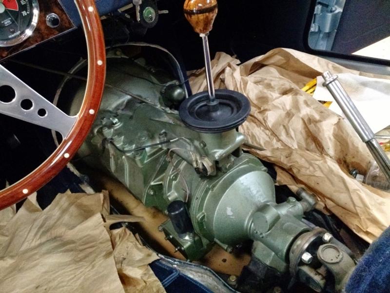

I just did this job. All will become clear after you remove the tunnel.
On my car, the screws for the console are beside the console up into the dash and on top of the tunnel behind the radio area. There will be another screw somewhere near the back of the console but yours will be different than my '64 BJ8.
Remove the shift knob. Watch out when you lift the console over the shifter as it can mess up the leather around the shift boot.
There are clamps that hold down the tunnel. There should be a seal around the front and sides of the tunnel so it might not come up easy. The speedometer cable runs through the tunnel so you will need to lift it a bit and undo the cable.
Put down some paper to ensure that dirt or oil from the transmission don't get on your carpet.
If you swap out the solenoid, you might need to recalibrate the throw-out distance (search the forum for instructions). You can drive the car without the tunnel to make sure it is all working before you button it back up.
If your tunnel does not have good sealant or insulation, this would be a good opportunity to improve that before you put it back together.
