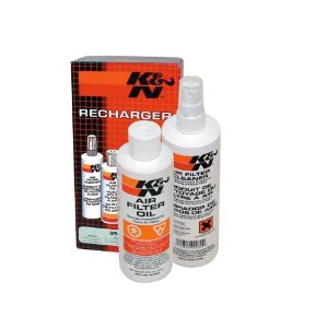

What's your thoughts on using K&N's air filter cleaning /oil kit on our air filters?
K&N oil is very thin--it looks like Marvel Mystery Oil--that's why it can be sprayed. I suspect the thinner the oil, the quicker it drains off the 'steel wool' filter media. The tribal wisdom in aircraft maintenance is that straight-weight, viscous (100W) mineral oil sticks to cylinder walls the best and is preferable in summer or when engines aren't run very often. If not tack oil, then thick dino oil is probably your best bet. Heck, maybe gear oil would work pretty well (it smells bad, though).

I don't know about the K&N filter oil, but I have an itg foam filter (from Denis Welch) for my two HD8s that uses a spray-on oil. itg's oil uses a solvent to make it thin enough to spray. When the solvent evaporates, the oil that remains is sticky. To clean, I use a degreaser from Costco (smells like 409) and rinse with water.
Might be a good choice. Since it's blended for foam's larger pores it can be stickier; I think K&N oil can't be too sticky else it would plug the finer treated cotton--I believe that's what it's made of--media.
I think any oil would work--oil bath air filters work pretty well and I believe they're still used on some tractors--it's getting it to stick on the metal media that's key.
