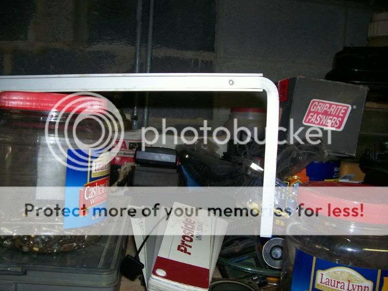

I found out that my midget really is toed out in the front. The gauge that I bought for checking toe would fit right up to the tire in the back but the tow eyes in the front kept it back about 2 inches. The gauge arm is tapered about 3/8 of an inch inward as it gets farther from the corner. I set it on a couple 2x4s a little lower and found out it was towed out about 3/8 inch. I think I got it now.
