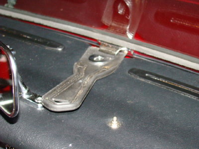

This the area I'm questioning; I have a plastic scraper underneath to prevent damage. If the bracket indeed goes underneath why have a hole in the wooden dash pad? There is a AH for sale on ebay that I noticed has the bracket on top of the dashpad. During mfg. I can see that if the WS is installed first then the dash pad later, the bracket most likely would be under. However, if the dash pad was installed first, then the bracket would be on top.

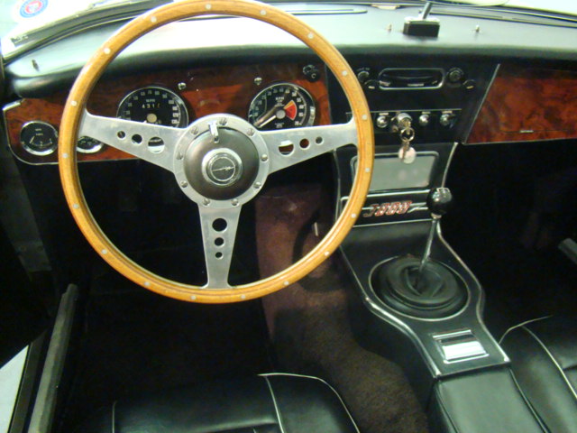

Here's a photo of the AH BJ8 on ebay that has the bracket on top of the dashpad. It's not easily seen, but it's there;
Also, if the bracket is under the dashpad won't it prevent the demister slot pegs from entering there drilled holes in the shroud?

Thanks GregW for responding. Your dash pad looks just like mine did. It too was shredded in the same location. Due to the thickness of the bracket it would prevent the demister pegs from entering there predrilled holes. I'm guessing that originally it was supposed to be installed on top of the dashpad but due to the WS being installed before the dash pad It was just slipped on top. I wonder if the concourse instructions can help here?
The crash pad definitely goes on top as the pad is installed well after the windshield is fitted. The hole in the plywood is there to relieve the thickness of the head of the bolt holding it in place. Otherwise, if you have to replace the windscreen glass you would have to take the dash pad off. The bracket on top of the crash pad would also look terrible. Ihave built a BJ7 and taken a few apart and they all have the pad on top of the bracket. Every BJ8 I have seen has the bracket below the crash pad.
:wall: Not to belabor the point, but if you have a copy of "The Healey Book" by Bill Emerson, on pages 179 and very clearly on page 182 these two photos clearly show the bracket on top of the dash pad. Both of the cars were BJ8 models.

On page 170 it is hardly able to be seen, and on 182 there is no dash pad so the bracket is clearly visible and on top of the shroud. You can see a bit of the bracket as it curves under the dash pad.
I checked my BJ7 and it's under the dash pad. Checked the shop manual, section PPP.6 and it says for both the BJ7 and BJ8 to remove the dash pad to unscrew the set bolt holding the bracket at the centre of the windshield bottom rail to the scuttle top. For appearance I don't think you want the bracket viewable through the windshield.
