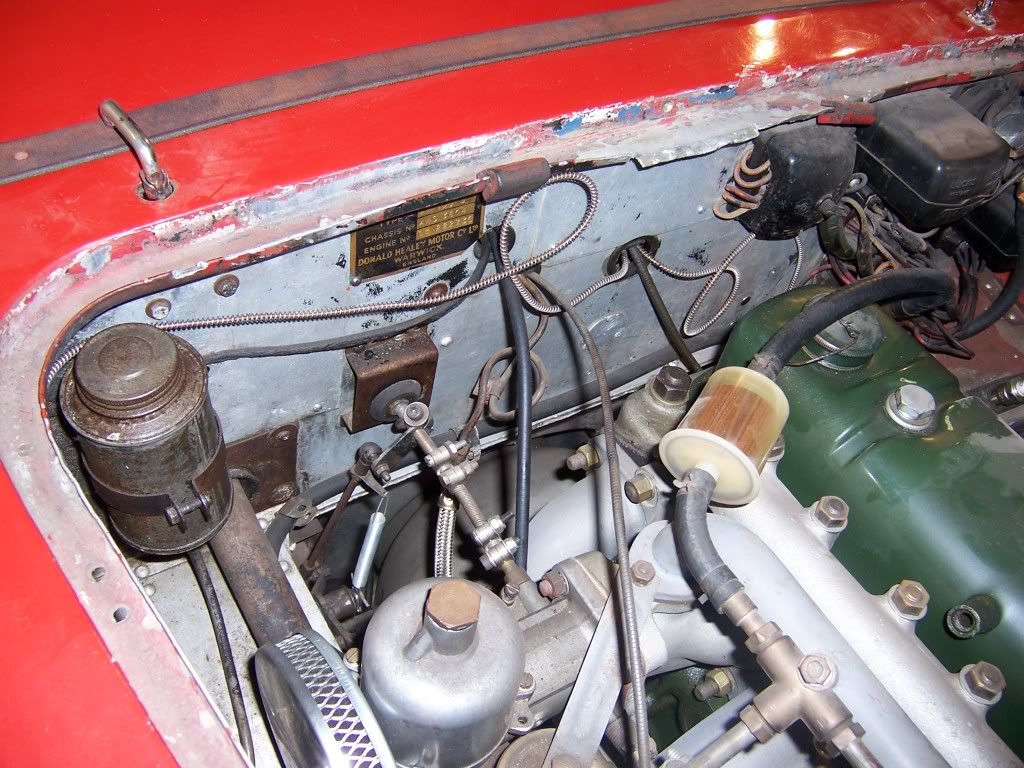

Hi, my 100-4 came with std carbs, 1.5" I upgraded to 1.75"'s as I bought a very bad rotted out M spec converted car. It was a late 1953 bn-1 car.
https://www.youtube.com/results?search_query=austin+Healey+100&search_type=&aq=f
You can see the set-up on You Tube.
If you want to convert, the easiest way is to get a set from a TR3 OR 4 using parts from your 1.5" carbs, the bowls, copper cross tube and other fittings you can almost get them to look like the original M spec set-up available in the 50's. The manifolds are available at DW. I tried M spec needles and ended up using the TR3 std needles and M spec dashpot springs.
