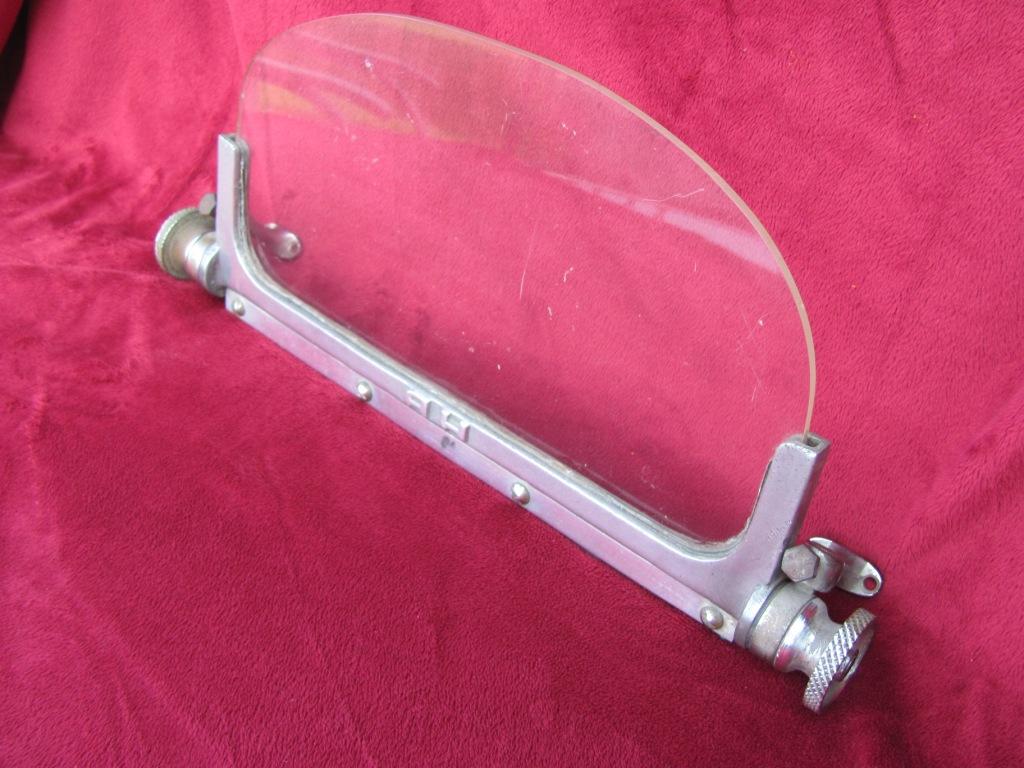

Please add a picture, would help others to see the difference with aftermarket one's

Here is a picture of the AH Brooklands aero screen that I purchased in 2012.

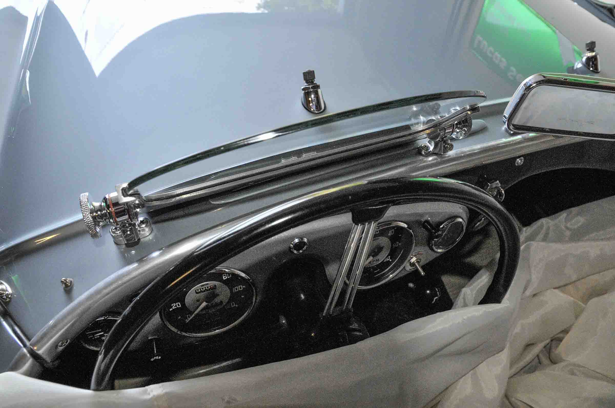

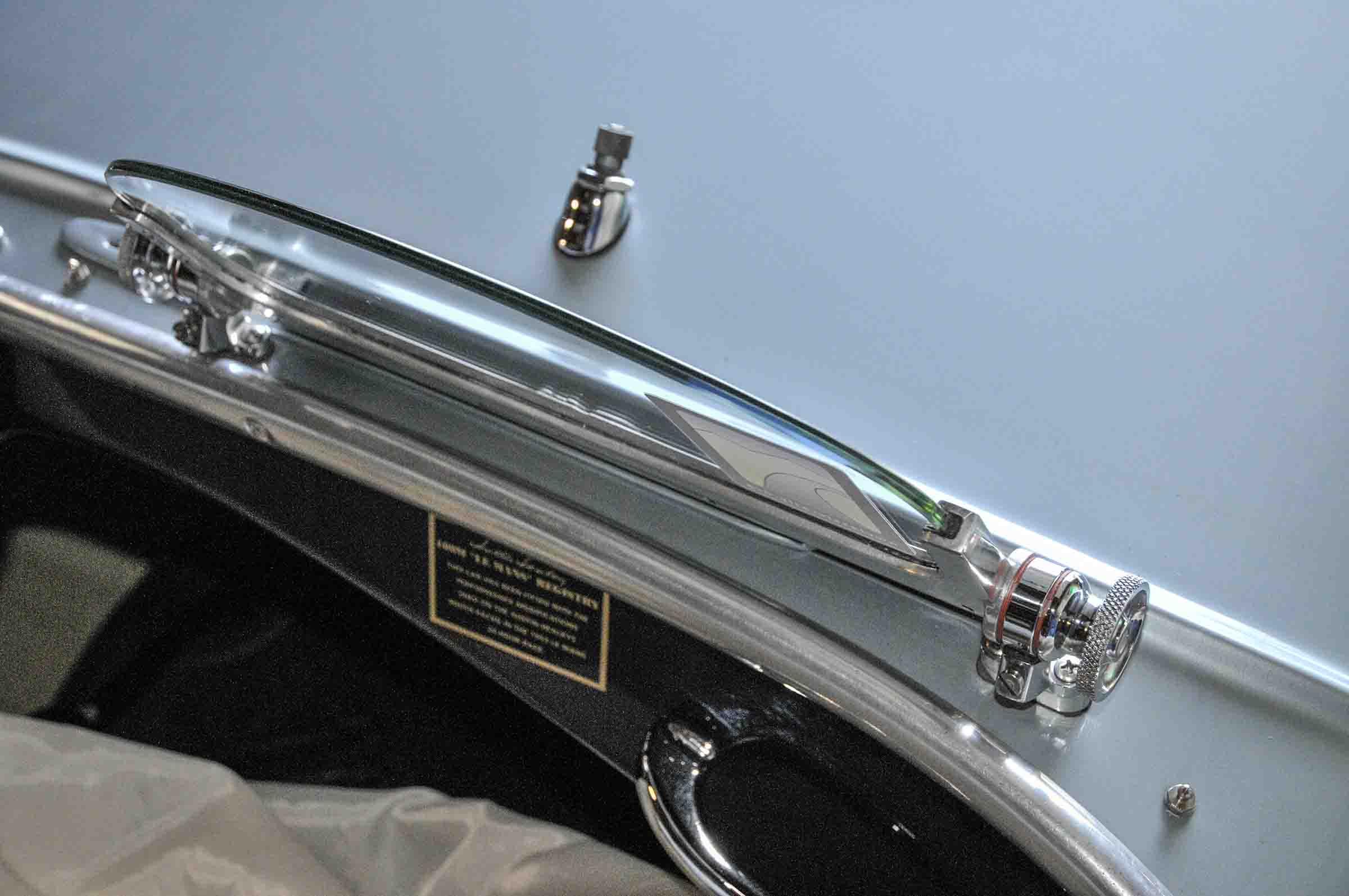

Looking at some period pictures and the screen construction, I believe that there should be a rubber gasket along the bottom, like the 100 windshield.

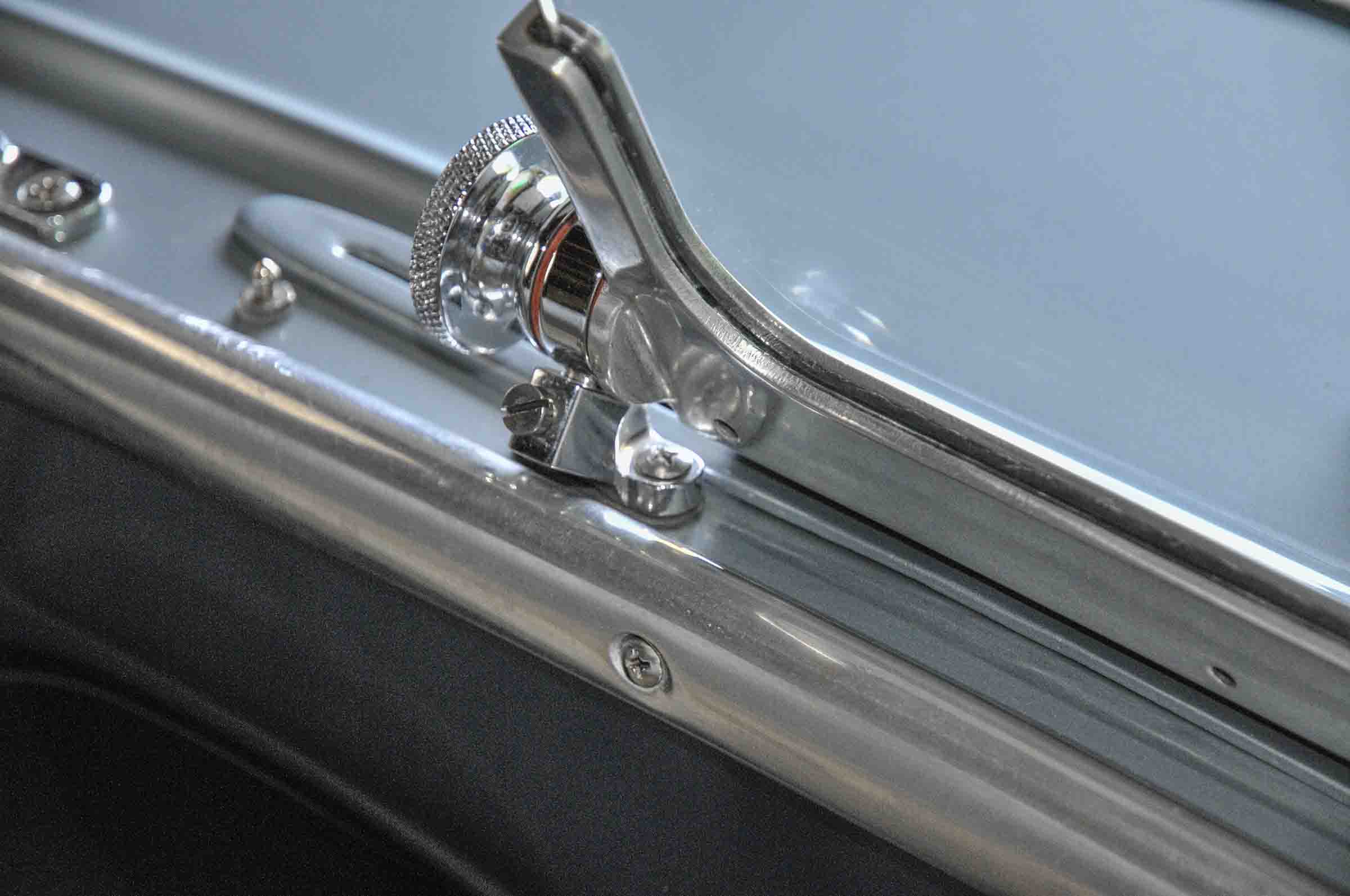

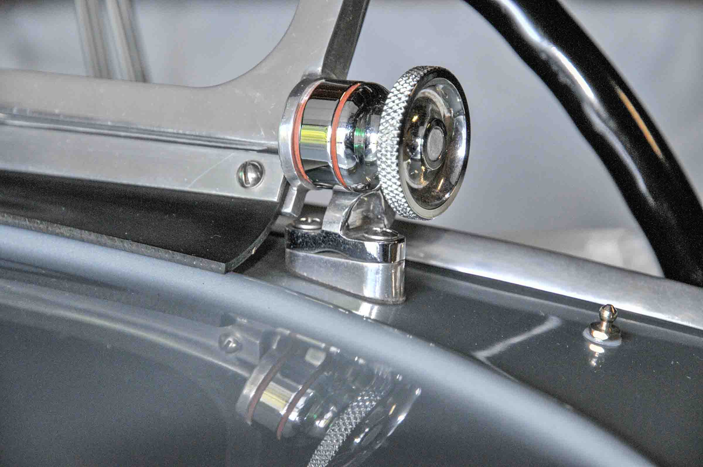

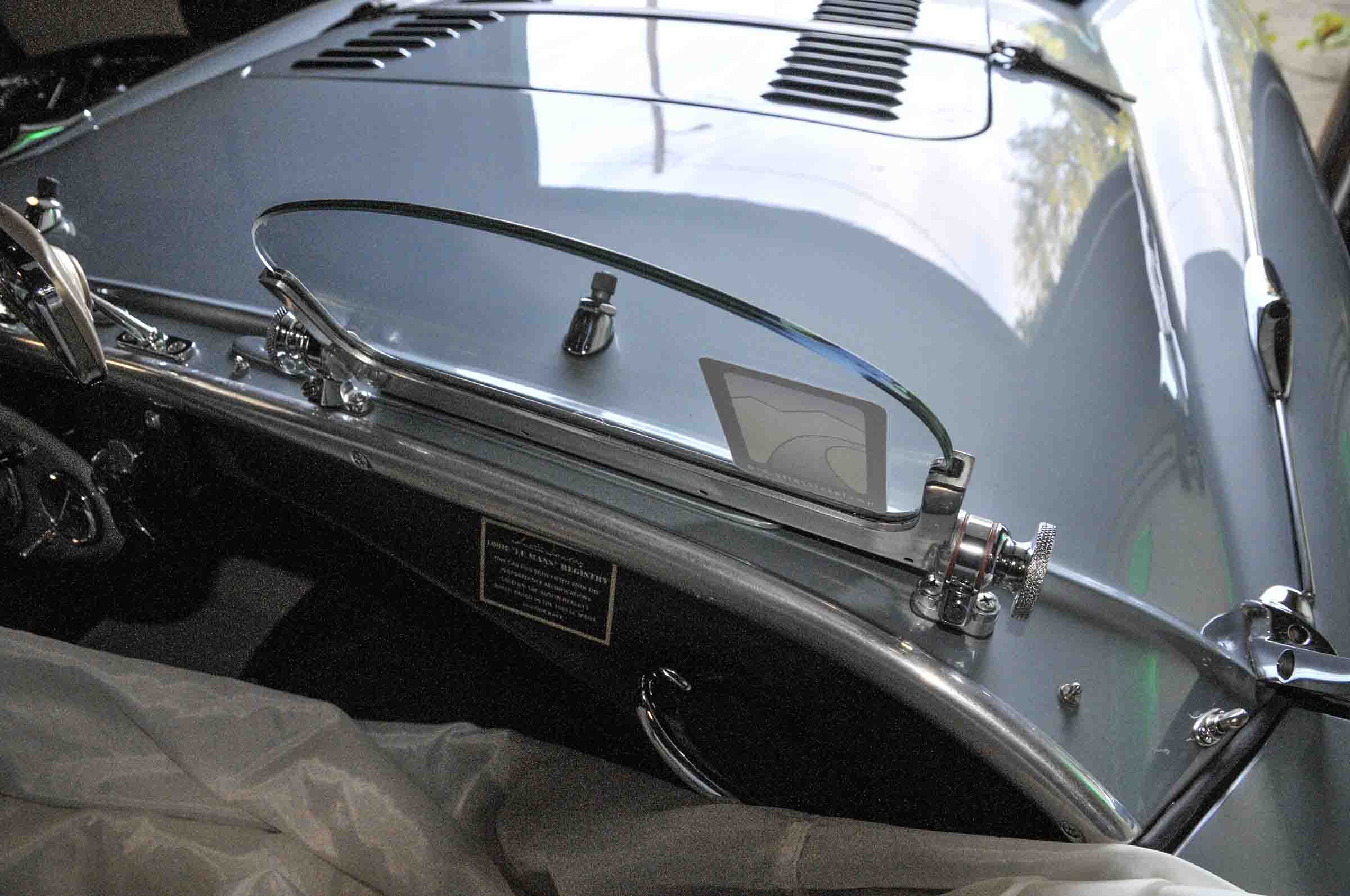

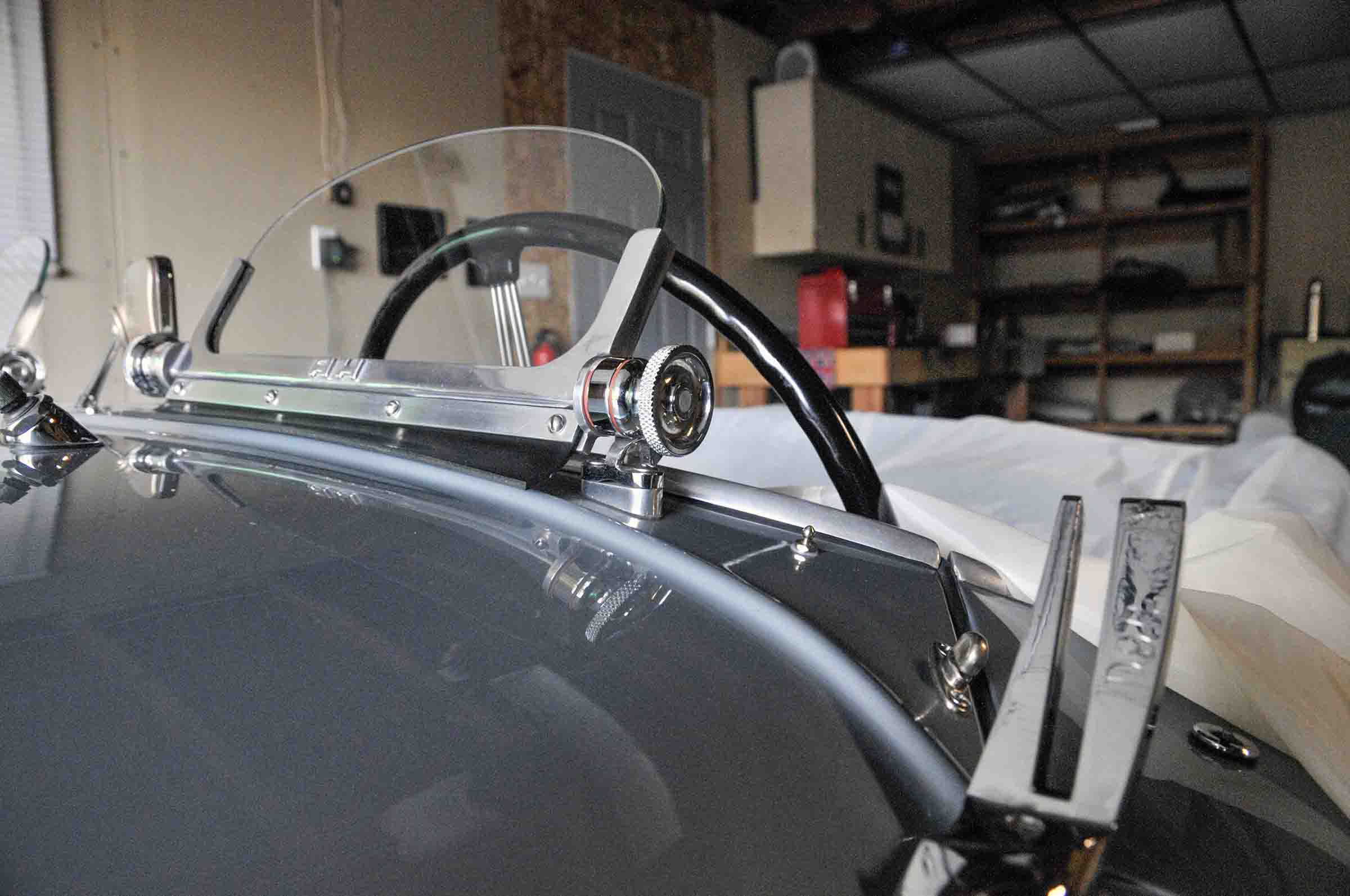

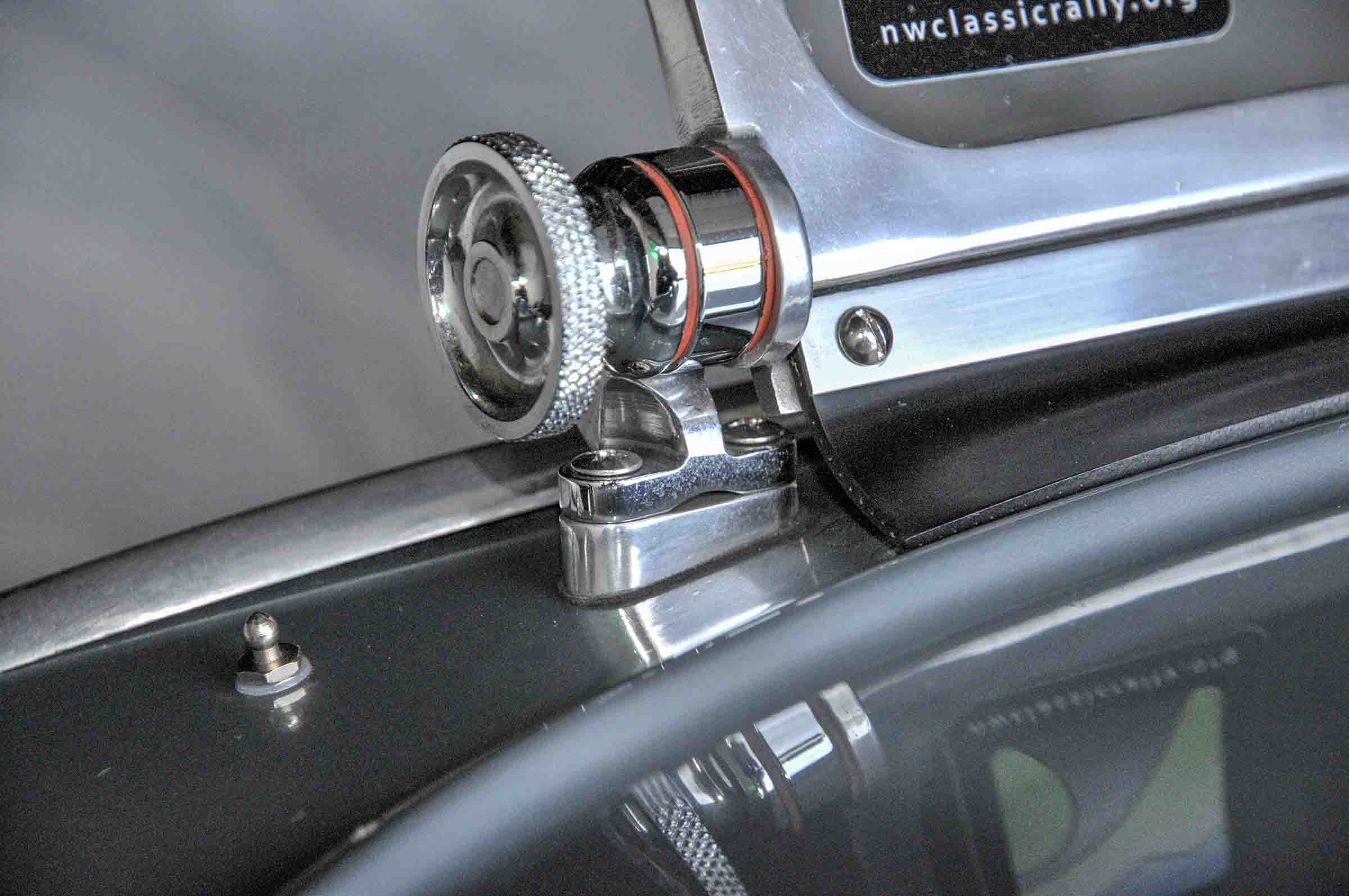

Peter Jaye of England made 20 reproductions of the AH aeroscreens in 1993. There were no other reproductions available at the time, and originals were expensive and usually in need of extensive restoration.
I bought two of the 20 and put them away, knowing that some day I would have a good use for them. They are of excellent quality and an exact match to the originals.
About five years ago "some day" arrived and I mounted them on my BN2. I spent probably half a day measuring and re-measuring before drilling the holes for mounting them on my freshly painted shroud.
For position I relied upon a template made for me by Al Alfano who, at the time, still owned the pink and black 100M show car. When Al acquired it, it still had the holes where the factory had mounted AH aeroscreens.
Paul Schwartz of Orinda, California, had made some mounting blocks to help them sit more level; one positions under the outside "foot" of each aeroscreen.
I made body gaskets.
I love the looks of a 100 with the windscreen folded, but I love even more the look of the aeroscreens. Plus you can still mount the windscreen with the aeroscreens in place.
I find that the aeroscreens deflect much more wind than you might think. It is perfectly comfortable to drive long distances with nothing but the aeroscreens providing wind protection. You just have to remember to wear a good clip attaching your hat to your collar, because otherwise if you look up and the wind catches the brim of your hat, it's quickly gone!

Beautiful. Actually much more elegant than the original. I have been toying with how to mount mine and I like the idea of he block on the outer side slope of the shroud. Otherwise the screen has a slight cant to it.
