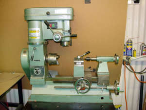

I don't have a lot of space, so I'm considering buying a used multipurpose machine for my garage. I primarily just need a drill press. Is this a decent piece of equipment? I know it isn't going to be great quality but is it going to perform well enough? Is it worth $300? Will it function as a drill press as well as a normal drill press?
Central Machinery - Space saving machine turns, drills and mills. LATHE has a 7-1/4" center height with 14" between centers. DRILL PRESS has power to spare. MILL has the capacity to mill a facing diameter of 2-1/2" and a milling diameter of 3/4". Features include #2 Morse taper, regular and fine quill feed with lock, swing asway head and a separate motor for the milling head.

I've done my fair share of machine work, and the lathe with drill mechanism pictured doesn't look to be suited for drill press or mill work. If you want to to drill press and mill work, there are a number of small drill/mills around that should suit your needs. If you want to do lathe work, get a seperate lathe. It's pretty hard to combine the two processes without compromise.

You refuse to buy a Chinese drill press, but you'll consider a Chinese 3 in 1? I'm a bit confused by your stance.
The unit you're looking at is a lousy drill press. The chuck is in the way, and you're drilling against the bed of the mill and lathe.

What does "swing away head" mean anyway? I assumed it meant that the entire drilling head would swing 90-degrees to get out from over the rest of the machine. This would make it just like any other drill press. But I'm getting the feeling I'm wrong about that!
I'm not familiar with the particular machine you're looking at so I can't comment on that (but I suspect that the "Swing away head" just moves it to the side to make access to the lathe easier and doesn't turn it into a drill press).
Before you take the plunge on a machine I suggest you spend some time researching (as you're doing). (Are the instructions for that machine available on the net?)
Although you want the machine for learning, consider that tooling is expensive and can easily exceed the cost of the machine, especially a used 3-in-1. You should make sure that your first machine uses standard tooling (tapers etc) so you can retain your investment even if you replace the machine.
Many people frown on multi-purpose machines because of setup time issues, rigidity, quality, and so on. I agree with them - dedicated machines are better. However, if space is an issue a 3-in-1 is way better than nothing and can be an enormous help dealing with old cars.
My suggestion is that you hold off a bit & look around. Look at the forum (they call it a BBS) at https://www.homeshopmachinist.net and ask a few questions there. (Pay attention to their comments on Smithy machines, many of which are multi-purpose).
