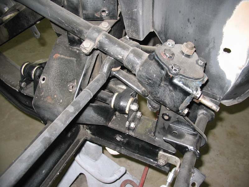

You didn't make a mistake if the frame is better that the one you want to replace. All you need to do is fabricate the bracket you are missing. I had to do just that on the late TR3A that I restored recently and I had to use a rust-free frame that came from an early TR.
I assume that your TR is an early car with the one-piece steering column. Like mine.

Gordo, I agree with Don. Just fabricate the bracket (or cut one off the old frame) and weld it to the new frame. It doesn't really take any force, just keeps the lower column from vibrating. But don't forget it all has to line up, and there isn't a lot of room for adjustment in the stock bracket. You need to get it positioned both up/down and left/right.

I have TS56698L. Just like the second of Don's pictures. I guess we're talking about the same "U" shape turned on its side. I have the 2 piece column. Is that right for this number car?
I took some good measurements, got out my die grinder cut it off the old frame. Will be welding it to frame this weekend.

Yes the split column or what you call 2 piece is right for approx. TS - 42000 up to 3B.

The purpose of oversize hole is so that one can adjust the angle of the steering unit upon istallation. The two halves of the split column must align or the steering will bind and the wheel will be hard to turn.

Exactly. The steering box can also turn in the lower bracket to adjust in the other plane. So both of these and the upper bracket should be left loose until you have the upper half of the column installed and coupled to the lower half.
