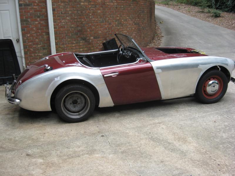

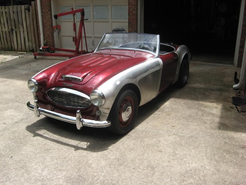

i am moving along with the healey that i bought several months ago. it had huge fender flares so i have installed new fenders. the rear fenders have a one inch lip/flare. i had a pair of healey steel wheels widened to 7 inches for the rear. looking for advice on rear tires that will be tall enough to fill the fender opening. the car as pictured has a set of low profile tires just for rolling purposes. i will need a tire with decent width and a tall sidewall in a 15 inch size. thanks for any help or advice. please excuse the disarray of colors! thanks for any advice or recommendations. and, a picture could be helpful!

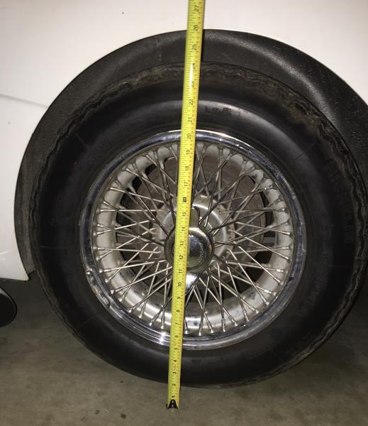

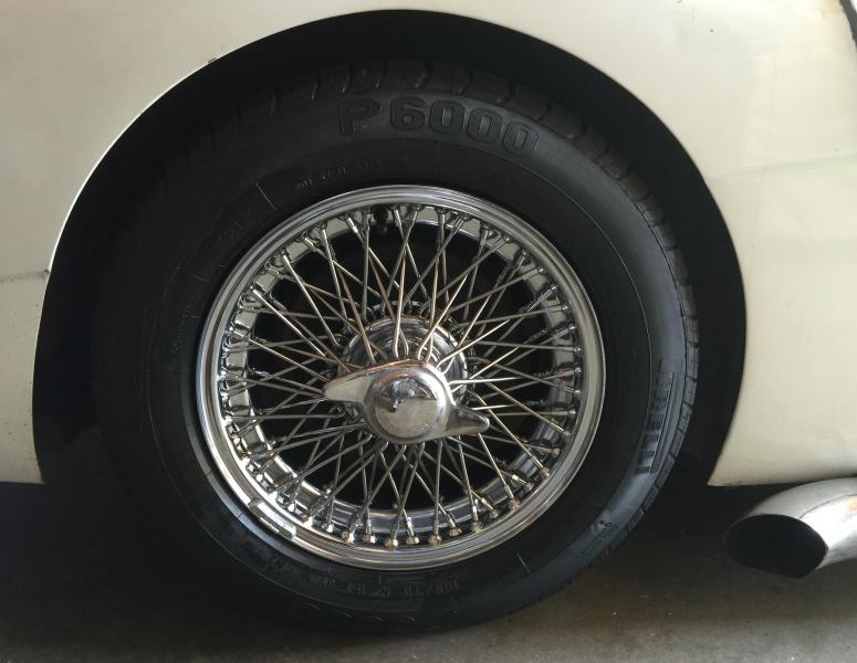

My BN2 with a SBC came with very old and cracked Michelin XWX 185/70 VR15. They are very expensive ($350 each) and available only as reproductions so I went with a modern tire: Pirelli P6000 same size for about $200 each. The Michelin had this great old school look with the bulge side wall but I've been pleased with the Pirellis. You would have to watch the size for the rears. I have Dayton 6" wire wheels in the back and they are tight for my original fenders.
Here's a shot with the Michelin and one with the P6000s. The Dayton wheels at 6" are a bit wider that the Dunlop wires that my car came with so I was really careful about fitting. I have a narrowed Ford 9" in back.
