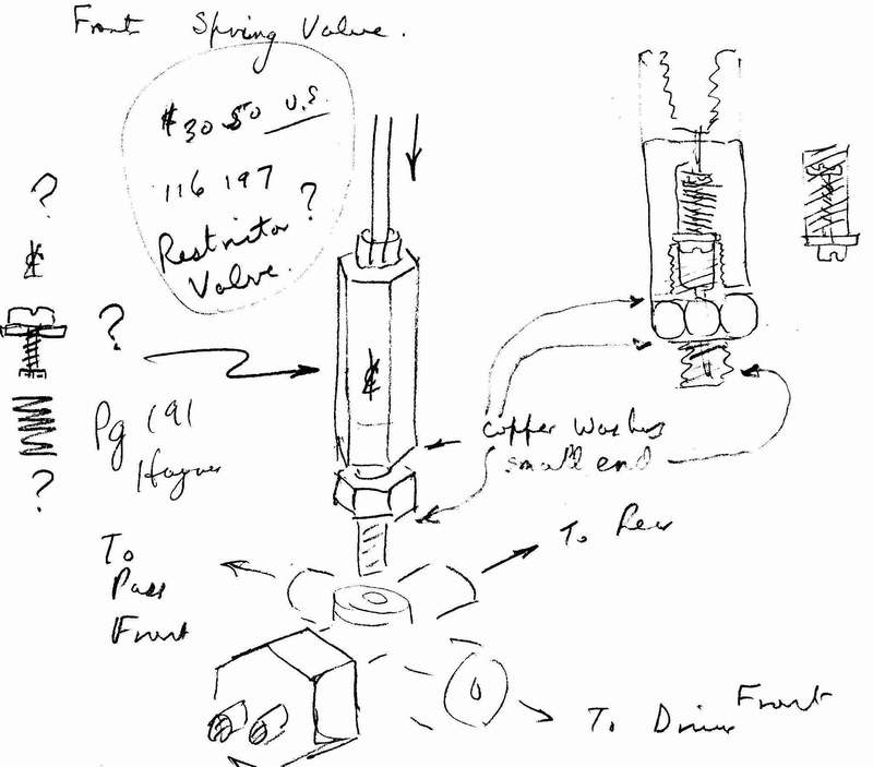

Also, if your TR3 has front disc brakes, there will be a residual pressure valve screwed into the top of the 5-way, which IMO you should also disassemble (taking careful note of how it comes apart) and clean. Since I didn't like having the brakes drag, I left out the internals from mine when I put it back together.

After you take it apart, you'll be glad I sent you this.

One quick question related to TR3driver's comment -- I ran into the residual pressure valve screw as I disassembled the unit (thanks Don for the drawing, it was immediately helpful) and my son and I puzzled over it for a good 20 minutes. What is its purpose and what are the pros/cons of leaving it out?
The RPV is supposed to hold some pressure in the braking system all the time. In theory, this keeps the front caliper pistons from being pushed back into the calipers when the front spindles flex in hard turns (or more accurately, when one piston is pushed in, the other one extends). However, it also makes the brakes drag (when it's working properly).
Without the RPV, you can find a low brake pedal after taking a hard turn, which can be disconcerting if you are not expecting it. However, I have never found it so low that I couldn't get full braking without having to pump the pedal; and only rarely do I even notice a low pedal (ordinary driving doesn't cause enough flex to demonstrate the problem) even with wide sticky tires and various other suspension upgrades.
Even Triumph (actually British Leyland) eventually decided the RPV wasn't worth the hassle and expense, so it was deleted some time during the TR4 run even though the problem of spindle flex remained true through the end of the TR6.
