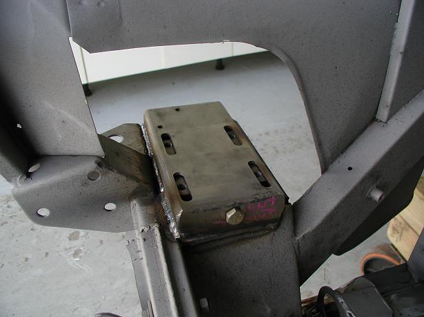

Ok guys this is how they work. First of all I think these were originally design to solve the problem of a stripped shock nut or one that broke loose of the factory weld altogether.
To install you cut the lower horizontal chassis weld on the outward shock mount and fold it up. With a chisel knock all or the remaining welded nuts loose. The plate slides inside this new exposed area.
The factory shock bolt holes are about 1/8" oversized and allows the shock/bracket to slide in and out.
You can drill out the holes further, but you can usually achieve close to 1 degree negative camber using the stock holes.
I totally removed the chassis fold on my racer so you can see the shock plate in the picture. On a show car you could refold and re-weld it back in place for a total stock look.
To adjust, loose shock bolts, put a camber gauge on the tire, pull in or out, tighten bolts and go racing.
Dougie

Steve,
No problem with the caster. If your looking to get over -2 degrees camber you might start having a problem.
Dougie
I have my race tire shop check the alignment, camber and caster with me in the car during every new tire change. It's about 2-3 times in a 6-7 weekend race season. Camber doen't change much but alignment can.
