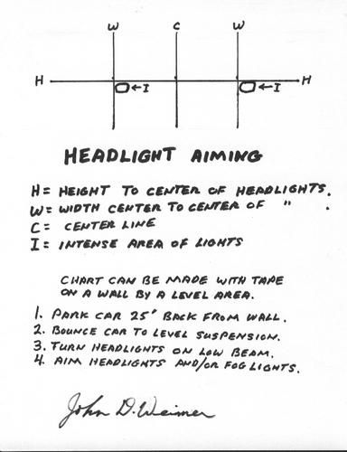

Here's another (similar) method as prescribed by John Weimer.
