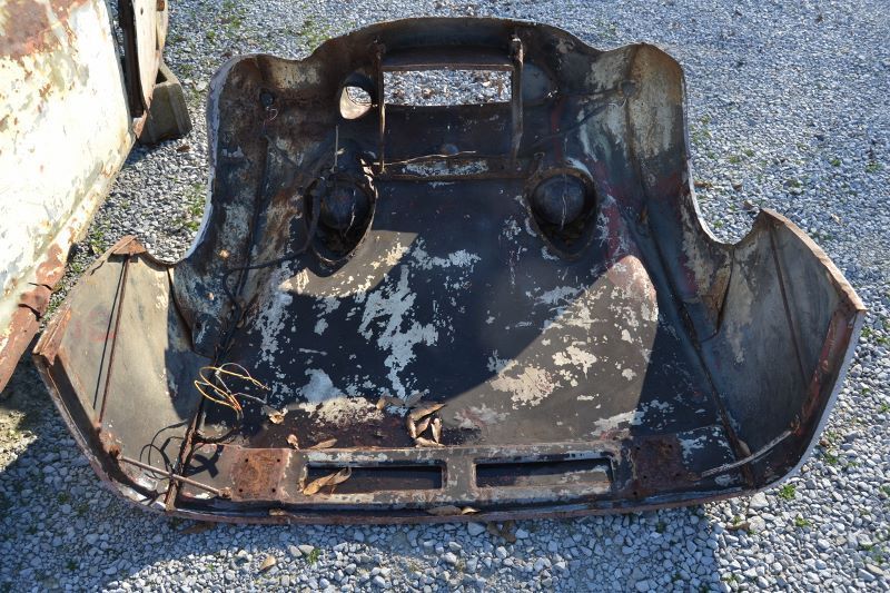

I didn't explain things very well. See photo below.
Ray from what I see someone has added the rods to strengthen the wings. I replace all the bonnet stiffeners on my current bonnet, both wings and center of bonnet, notice no provisions for wing stiffeners, but it wouldn't hurt to have something like that. I would however recommend stiffing the apex of wheel arches on the front wings to add in strength with 5/16 round stock around the arch.
This is a late 1960 car. So you think this was a likely ad-on rather than a factory mod. I will be getting the car next Monday so I can examine more carefully.
The long prop from the wheel well to the brace at the rear is someones solution to a bent panel.
Could be Colonel. I will be able to tell in a few days. Looks like a reasonable good idea regardless.
