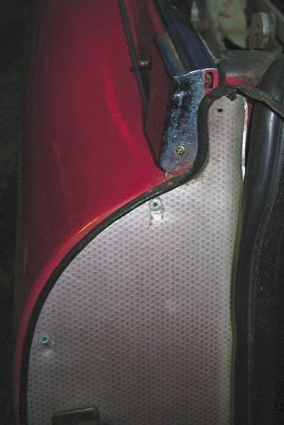

Andrew - I believe the pieces on my ’66 BJ8 are original. The material appears to be a finely ā€˜pebbled’ vinyl wrapped around a fibrous (?) cord. The vinyl is a strip about 1-inch wide. The cord, or what’s left of it is, or was, white-ish, and maybe a 1/32ā€ to 1/16ā€ or so in diameter.
The inner 'cord' stops where the door finisher turns towards the front of the car. The vinyl at this point continues and was tucked down behind the finisher. On the photo, I’ve pulled the vinyl up and out.
Hope this helps, Dave
