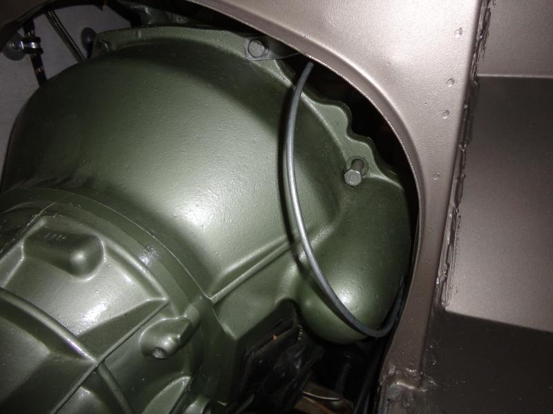

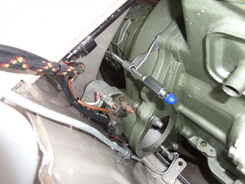

This is the unit that I got from Doug Reid(Mr Finespanner). Bleed the clutch from inside the engine compartment. Other units are similar.
