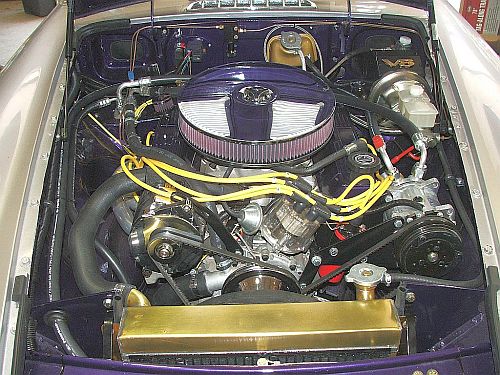

I have a/c in my 74-1/2 GT; Micky has a/c in his GT as well.
I sourced mine through Nostalgic Air; I think Mickey did the same.
My compressor is a Sanden 508.

Yep - as Rick said. But we each have a V6. Actually, mine is installed, but not hooked up yet. The evaporator unit takes up surprising little space in the passenger footwell.
So far, I haven't heard/read any reports about the A/C on the stock B engine. Don't know about the strain it might put on it...
Still, a small price to pay for a cool cabin.
