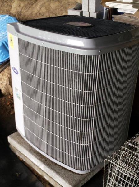

Feeling virtuous this morning. Cleaned, all by myself, our AC condenser unit. I've seen tech do it in the past, but thought I'd give it a shot. Was easy (though, obviously, I didn't check Freon and all that). Still, it must be much more efficient with all that dust/dirt out of the fins.

Congrats on the cleaning. What exactly did you do? Remove case and blow out unit with compressed air?

Basically, I did what the technician did (and I also saw on YouTube). Just a few steps:
a) used a shop vac with a gentle brush attachment to vacuum most of the surface stuff off the exterior, then
b) loosened the top fan assembly and a access panel so-as to get to the interior (of course, all power is turned off), then
c) used a hose to blast from the inside out... with gobs of gunk coming off.
They do make a spray that you can apply to the grill and hose off from the exterior.
Made a big difference as one can now see more light through the double-layer of fins. MUST be more efficient now.
The next time I do it, I'll likely let the techs do it as they will also check Freon and clean the interior exchanger (which is hard to get to).
