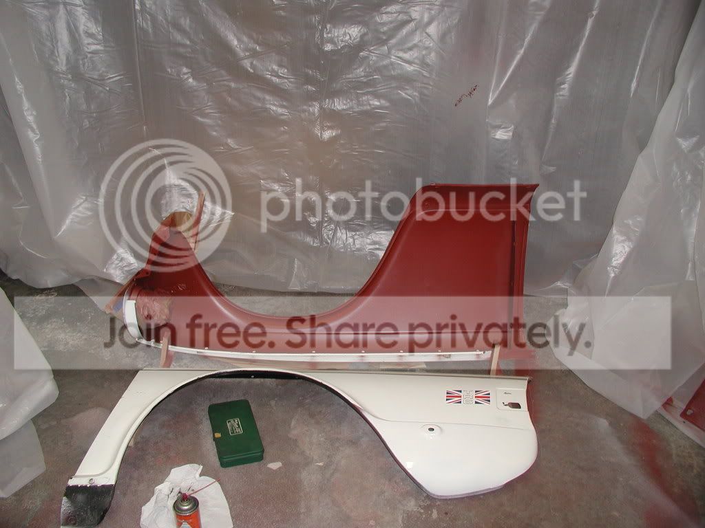

Here is photo of the fender after epoxy primer.
