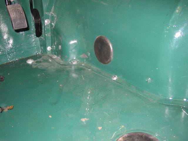

From your Comm. No., and if it's the original gearbox, the fill hole should be on the left side about half way up the side. On the late TR3A I rtestored last year, I made a hole in the side wall of the tunnel to make it easier to fill the gearbox and overdrive. Like Randall, I have used Valvoline 20W50 Racing oil for the last 17 years. I have driven 98,000 miles and had to re-build the gearbox once (2004) because of my mistake. Not because of poor reliability.
