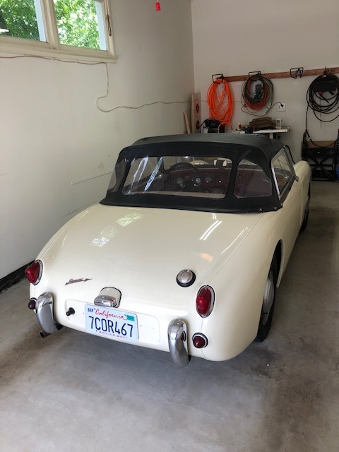

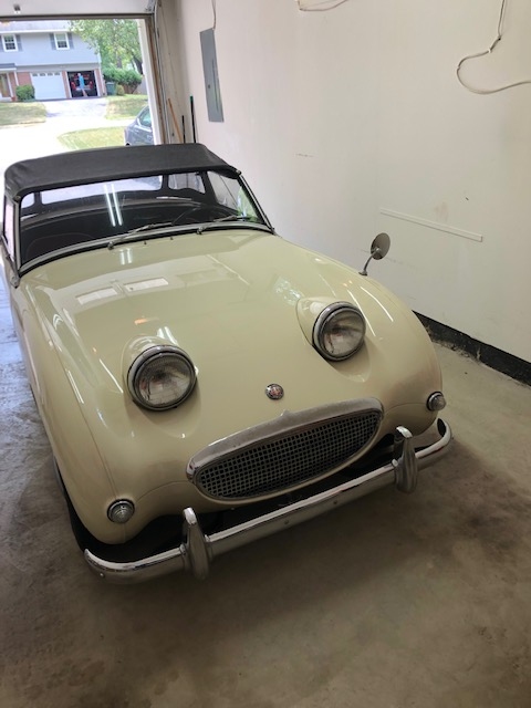

This is the beast I am taking care of. I was only able to play with it about 2 hours when it was delivered, then I had to leave for the airport. It is in pretty good shape and drives well, though the LF damper is a bit soft. I will also have to decide if I want to leave the Weber downdraft on there or install the original SUs.

I vote SU's! also, Peter at Worldwide Auto is your guy to replace the shock > World Wide Auto Parts of Madison <
I get my parts from Moss, only because I have a local distributer close enough by that I don't have to order them (Mail order to Canada is generally a PITA)
There are a number of reputable suppliers though right now we have also been hit with supply chain issues - a number of members here find it easier quicker and often cheaper to order directly from the UK - go figure!
