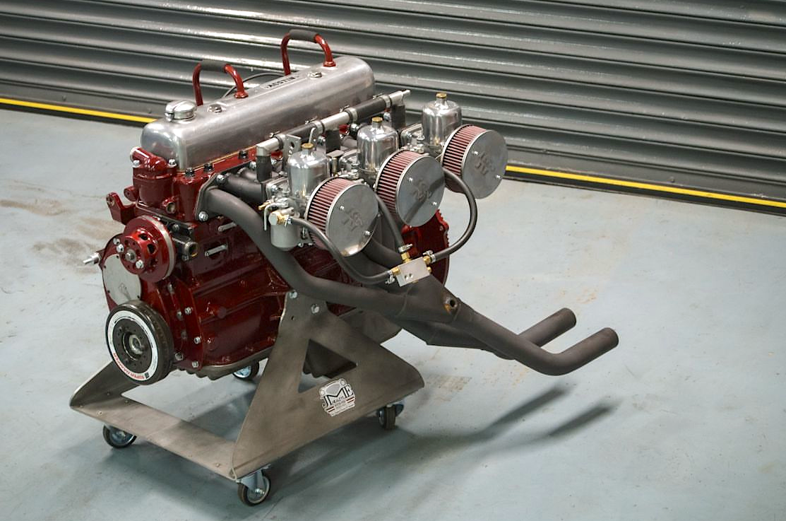

Does your motor look like this? If not ....probably just a DIY repaint job.
