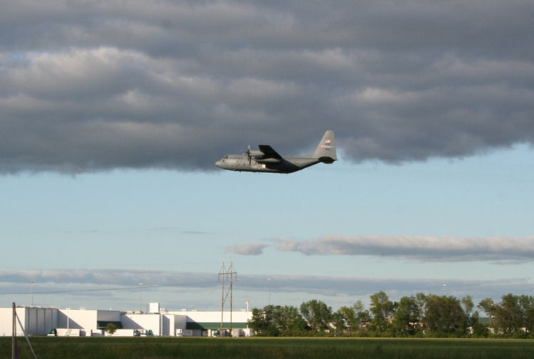

When the skitos get bad up here in the summer they start out spraying with cessna mixmaster then to a c130. They fly them over the city at about 250 feet which is quite a site.

The SAR guys like our area, with a small boat harbor, they practice air/sea rescue. Neat to watch the loading ramp go down, then the parachute stuff, then the guys. The C130 then circles until the end of the exercise.
But a C130 at 250', that would be something. Never would happen here in zero tolerance Santa Cruz where they are suing the state over the moth eradication program.
