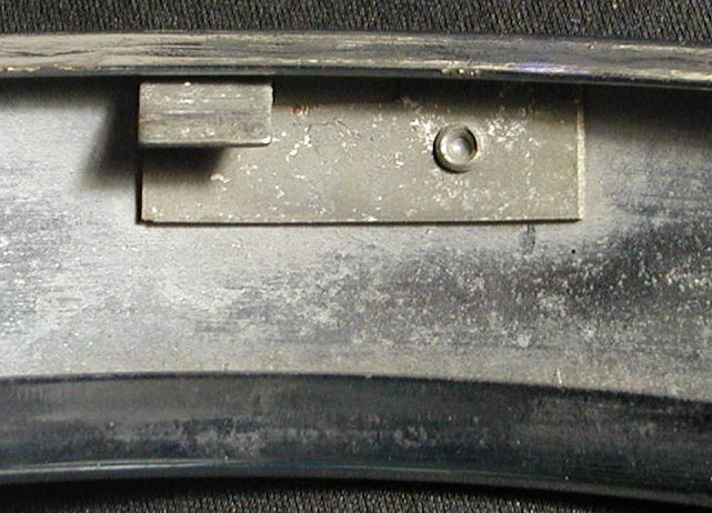

Rob,
On some cars there was a tab rivited to the headlight rim that was used to help lock the rim to the headlight bucket. My MGA's have that tab on them. Have a good day!
John
John, Thanks for the suggested reason for the rivet in the headlight rim. I checked my original rim and did not find any tab attached. Just the rivet. So maybe they were like the port holes on the 50's Buicks...for decoration only.

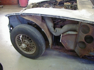

I just found a photo that shows the two rubber buffers on the wheel well.
1 O'clock and 3 O'clock on the front wheel.
They are painted body color.

I agree.
Maybe the tab had broken off?
My original headlight rings on my '58 BN6 has the tabs as shown below:
Thanks Duane for the picture. I don't see any evidence of a tab being there, but I now remember both of the original rims were damaged 40 years ago when some one backed into me....so these would be replacement rims from that time and maybe they discontinued the tab but kept the rivet for the look. Again, thanks for taking the time to answer this question I have had for many years.
