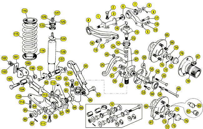

Dale, That certainly looks like a shock bushing, but for a Chevy!
It's not a sway bar link bushing, is it?
I don't see anything resembling that configuration on the exploded view I posted, but I'm not really a TR6 guy.
