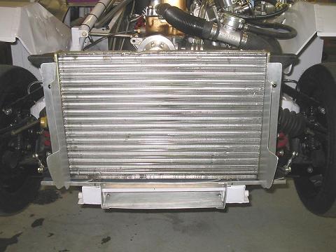

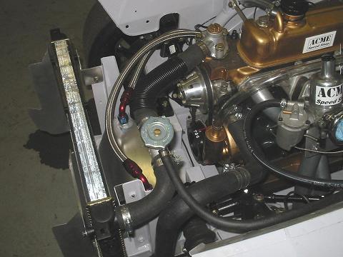

Jes got my custom fabbed Alum. rad today and started the pre fit checks. A bit of manuvering but should go well. Had to make a 10" pusher fan but bolted up quite nice and had to get a 25mm longer belt to swing the alternator over away from the outlet thats now on the top. Ill have to weld some custom adjustment arm for the alternator but this honking radiator should keep it all cold. Lighter than stock, but 2 1" core rows will be cooling the H20. new rad is very close in width and hieght but 1 1/4" thicker, and added the conveinece of a drain petcock. More to come.
