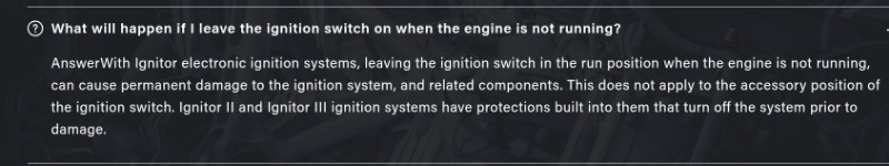

a little background first. ive been running Pertronix ignition in my 3A for at least 15 years i have always carefully observed the "don't leave the ignition on without the engine running for more that a few minutes". So I had been working on a light issue and inadvertantly left the ignition on...OVERNIGHT....battery dead the next morning. Fully expecting the Pertronix to be fried I was certain I would need to order another one. After charging the battery I thought I would try to start the car fully expecting nada. Now the fun part...fired right up. Runs and idles fine. Have not taken it out for test spin. Being I would rather be safe than sorry Ill replace the module anyway. Thoughts on why it didn't fry? My other concern is the coil. Reistance measures OK on both primary and secondary coil but again wonder if it can be trusted under load and at higher RPM. Pertronix site mentions leaving ignition on can also damage coil.
