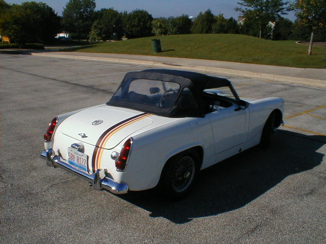

Ray,
That is looking REALLY good.
I have been watching your work with much interest as my 62 Midget looks to be in comparable condition to your Sprite (before). I even have forward floor pans that someone fabricated out of a road sign and a poorly fitting boot lid just like yours.
I have to do a body restor with my Midget but am having too much fun driving it. Someday eventually.
Great work and thanks for the web site.

Willie,
Do enjoy it for a while if you believe it to be sound enough. I would encourage you to get it up on a lift and really check out the rear suspension, just to be sure.
I did the basics when I bought mine, but in truth, a 5 minute session laying on the ground with a 2" inspection mirror was far from adequate in determining the state of the primary structural unit, the rear bulkhead and spring pockets. I'm sure you've already seen just how bad they can be since you've visited my Spridget Project site ( https://www.raysmg.com click on "The Spridget Project").
After finishing replacement of the key components mentioned in the opening post I have concluded that most of what we normally scope out, the pans, sills, and footwells should really be secondary concerns. The bulkhead and "B" pillars are the structural foundation of the car.
