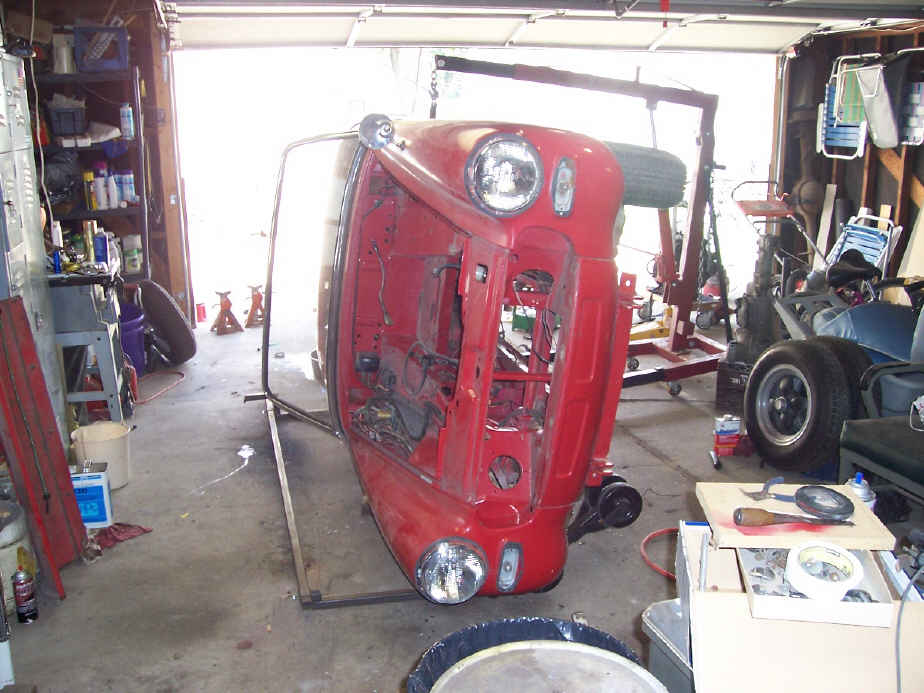

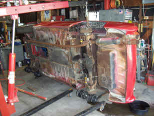

This is what I did today. I flipped my Sprite on it's side so I can weld some patches on the floor. I figured it would be easier like this. I built the tilter for another car and just made new hub plates to fit the Sprite.
Glad it was you and not me. Scary that.
Actually the way it's built it can't go to far. Just pick it up with the cherry picker.

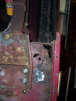

And I just roll mine over on the grassy edge of the driveway.
I just picked up a 67 that needs floors, it's almost ready to roll over in the grass /bcforum/images/%%GRAEMLIN_URL%%/smile.gif What the heck, it's not like I am worried about the paint.
And of the several I did already, it's amazing that nothing happens to it, not even a scratch in the paint.
