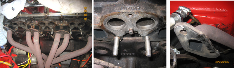

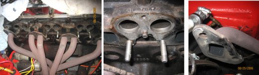

A photo of what I have right this moment is attached.

You appear to have headers not a stock manifold. At least to my eyes here...
Cut the connecting pipe(s) under the car as close to the end of the headers as possible - if you can't seperate them normally that is. It should slide right out of the top then.
The join is about a foot behind the firewall if they are anything like mine.

Alana- I HAVE the header pipes disconnected
behind the firewall. I do not know how to get
the old gasket material off the metal sufaces
and to prepare the metal surfaces for the new
gasket and all the new componets. What needs to be accomplished before I put the new gasket in place.
How do I install a new gasket? Bentley does not
tell me how to install the gasket.
Can I use a straight blade razor to remove the gasket remnants? Or for example. Should I spray everything with silicone/oil or DW-40 oil before I place the new gasket??

Sorry - misunderstood; that said then I'm with Sammy - take out the starter. Its pretty easy.
As to the old gasket material, I'd use a scraper. Others might have a better idea as I didn't have that problem.
From what I remember the new gasket just gets clamped in place. ISTR metal side in, but that was in one of the books and someone here will correct if I'm wrong.
Why does the header have to come out of the car??? In the picture, it looks as if there is plenty of room to clean up the surfaces on the head and the header. Use a stiff putty knife/scraper...one that has an edge. You can also use that razor you mentioned if you have one of those holders for them. The razors are good for the final touch-up work... to get the last remnants of the gasket off.

My thoughts on the matter are that it's the gasket that does the sealing. The only time I use anything when installing a gasket would be just to hold it in place to make the assembly a little easier. Since you have those studs sticking out, they will hold the gasket in place.

All surfaces are now cleaned with straight edge razor
and wiped clean with mineral spirits. All visible debris
removed from ports. Will re-install exhaust pipes and
then re-install PVC plugs to seal intake ports.
d

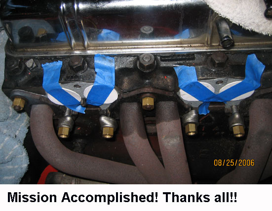

Mission Accomplished-
Engine sealed tight for the night!
Thaks everyone for the guidance.
d

True dedication tinster! I would have put the plastic bag over me and start running for the house.
/ubbthreads/images/graemlins/cheers.gif
Harry
CT
Glad to see you got it sealed up. I noticed the new brass nuts; did you change out the studs too?
I hope the storm is not too bad on you guys. Many of us on the Gulf Coast are watching that storm with all hopes it dissipates, but it looks very scary in the forecast.
Yes, changed out the studs I could easily remove.
I did not want to risk snapping any off w/ excessive
pressure applied.
