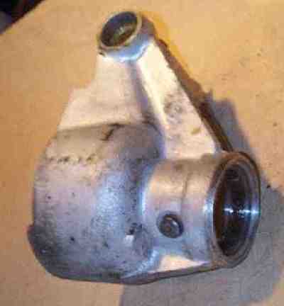

My '85 XJ6 w/65,000 original miles just started making a strange noise in the right rear...find its in the hub (aluminum)...the bearing seems to be seizing...can I replace just the bearing or must the entire aluminum hub be replaced (I've got another complete rear suspension if necessary)?
If just the bearing is bad, that's all you need to do. But if the bearing has froze and spun, you will need to replace the housing and/or the stub axle.
But it may not be the bearing. Check the housing for cracks.
Bearings can be replaced. A little tricky on the home press, but with thinking and spacers can be done. Not hard otherwise. While you are at it replace the lower little fulcrum bearings too.
Got the hub assembly out from under it....bearing appears to be sticking...think I can get it out...wil check the hub asembly itself to make sure its not damaged...

remove the round black plastic cover shown in the picture and inject grease with a grease gun, usually takes care of it.
Good to know about that place for greasing....I've got lots to learn about Jag's...when I talked with the local British car repair place everybody recommends, they said they'd had a history of replacing aluminum hubs themselves when the bearings go bad as the aluminum gets damaged so easily.....I've an extra hub on my parts car just in case.
