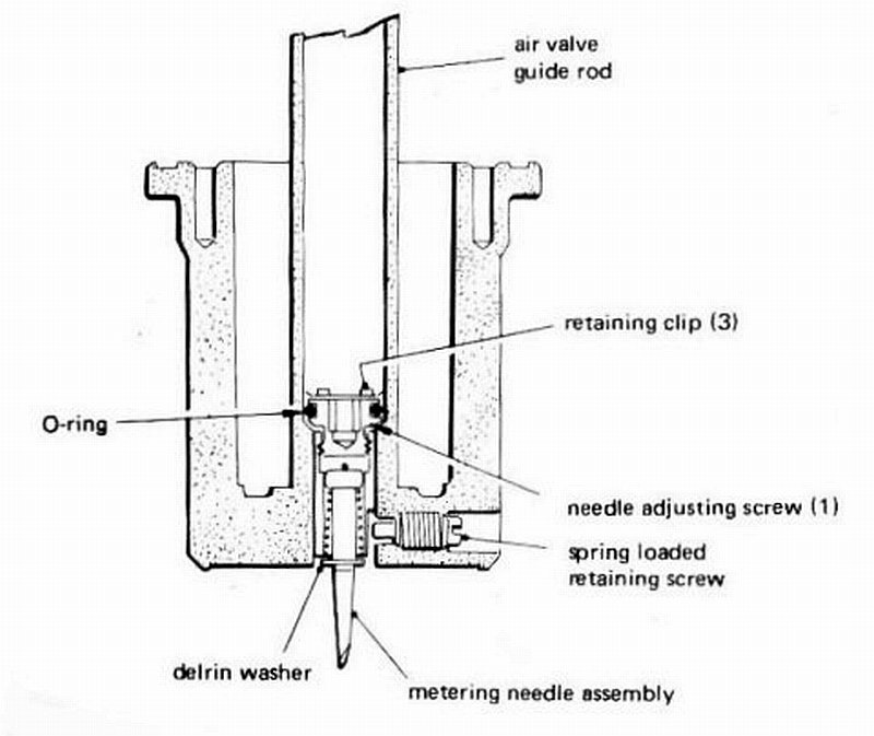

If it's like the earlier CDSE2 carbs, there is a seal on the mixture adjustment, that lets the oil leak out when it gets tired. You can either keep filling it, or take the carb apart to replace the O-ring. IIRC the O-ring is not included in the rebuild kits, but is a standard, readily available size.
I think I'll take the thing apart, The ring your talking about is on the bottom right? by the float chamber? or do you mean on the top my the damper?
It's down inside the damper. This drawing is for a TR6 (CDSE 175), but I assume the 150 is similar.

What I have there is that the needle was out too far because the retaining screw wasnt tight enough, the garage who last rebuilt it left the screw head broken so I need to drill it out.
The gold case the needle comes out of was coming out of the whole piston, that seems to be the only problem I can find there. I'm going to give the garage a call.
You shouldn't need to drill even if the screw head is stripped (which is easy to do, it's just relatively soft brass). Remove the needle & carrier then stick a suitable rod in the hole and tap the screw and retaining clip out through the tube.
IIRC, last time I used an unsharpened #2 pencil, and rapped the end of it on the bench to drive the screw out.
